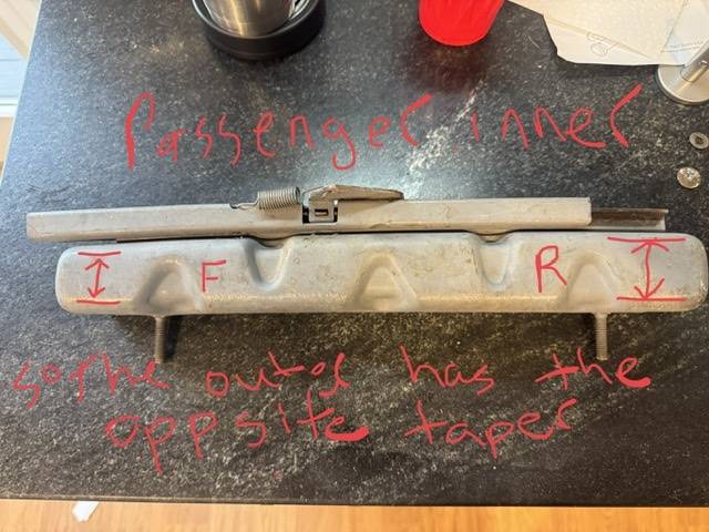

Is this inner seat track driver side or passenger side? I think it passenger side.
Driver side - when the seat is adjusted back the big spring helps bring the seat forward when adjusting. Correct?
What’s messing me up is the taper from the outer to the inner are the opposite I believe?
Thanks for the help
So the taper of the track is the opposite from the inside and outside tracks
Not sure why I thought the taper was the same on the inner and outer.

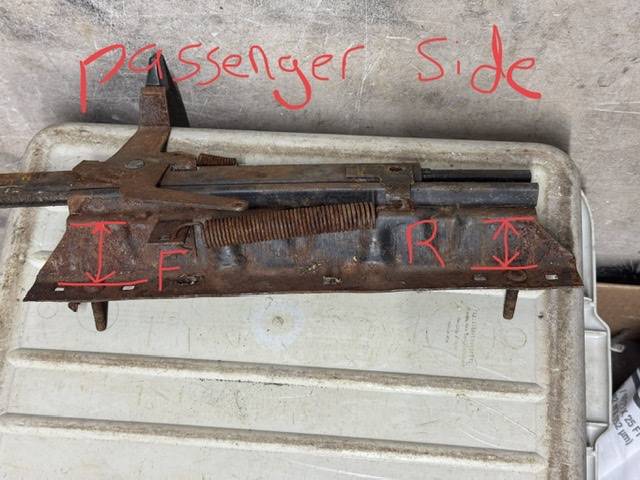

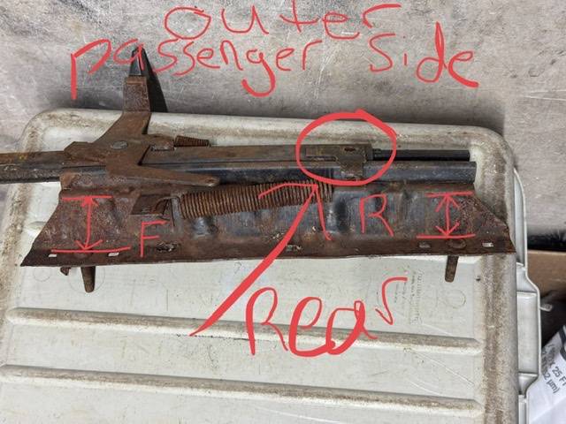

Passenger outer. I guess I never realize this. Always thought the taper would be the same inner and outer, not so
I believe the brackets are higher at the front. The passenger side outer moves forward when the release is pressed and the driver's seat moves back.
Yes on the outer track it is. Not on thee inner, it is higher in the rear as you can see above. I believe both seats pull forward when adjuster is released.

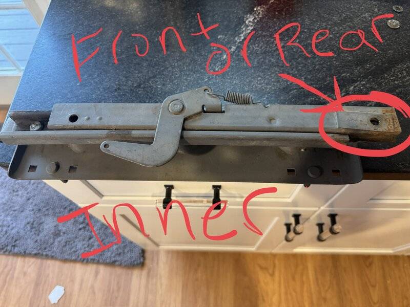

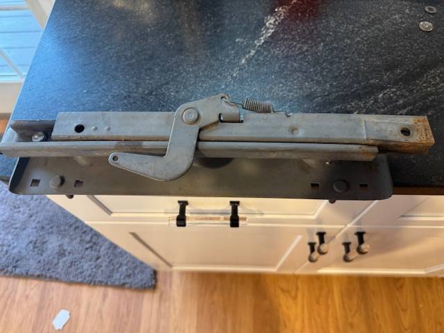

So the inner track above is a drivers inner?
The inside track you have a pic of looks to be the drivers inner. It’s higher at the front. At least that is how I assembled mine recently. They are still sitting in the basement.
