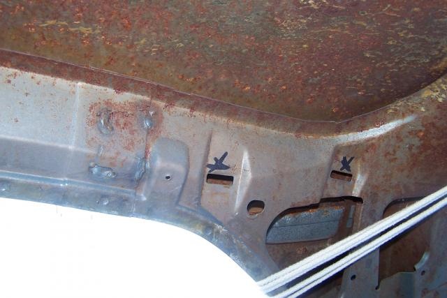

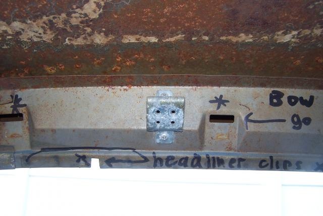

I'm trying to figure were the metal bows and clip goes.
I bought my car without any healiner, so I have no idea were to put the clips and the bows.
Anyone have a picture? or any reference?
I tried the search and found nothing helpfull in regards of what i'm looking for.
here are some photos i will get back to you with more about the bows if i can find the info. the "bow holder things' go into the slots shown in the photos

this is info from my notes on the correct placement of the bows.
1-orange
2-peach (1 & 2 might be the same though)
3-brown
4-pink
5-green
6-much bigger than the others
the colors should be painted on the ends of each bow
i think #1 is at the front but you'll figure that out.
Good luck. I did mine for the first tine, came out real nice. take your time. hope this helps
