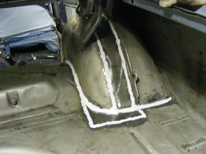

im in the rpocess of doing mine, here are a few pics for ya. its a 75 duster. and im planning on a 15X12 wheel with a 28/12.50r15 tire. anyway on to the pics.... its hard to tell in the pics but i should have 15 inches from the inner fender to the outer lip if i roll it or cut it i could gain another 3/4-1 inch. i have 3.5 hours in it to this point now i need to get it welded back in.

03ramit1, in your third picture, are those small cuts in the subframe?
burg
what we did is leave the pinch weld where the floor and subframe are spot welded together, then we cut in between the spot welds, and bent the lip vertical so that we can weld the wheel tubs to the lip and we dont have to go back in and weld the floor to the subframe again. (as it is still welded together)
did you fully weld the seams or spot weld them? i would assume spot weld if you covered them in sealer.

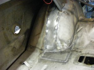

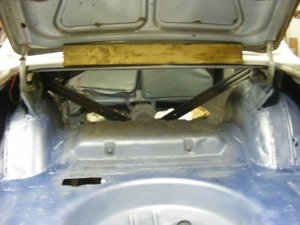

Sorry for the wait for the pictures.. finally got them downloaded.. now off to get the body work done..
The figuring out where to cut part took the longest but we finally got it and i think it came out good. what do yall think?

man they are good looking. i should have followed in your footsteps. how big of a tire will fit in that tub? (diameter not width)
a 13 inch tire would fit perfect.. a 14 would be a little to close for comfort to the frame rail. we have a 13 inch tire on an 11 inch steel wheel we are going to put under it and have a rear end cut down to size.
