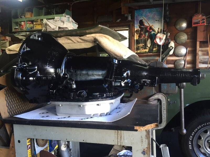

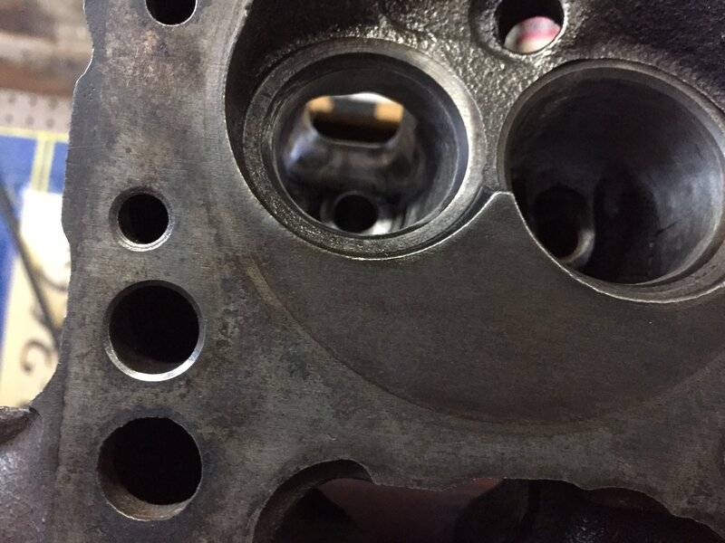

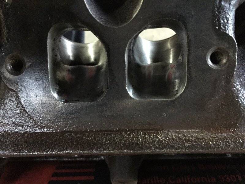

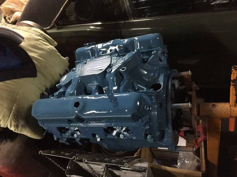

Here’s a couple shots of the motor assembled and port work on the heads. Also freshened up the 904 with a bigger pan and shift kit.

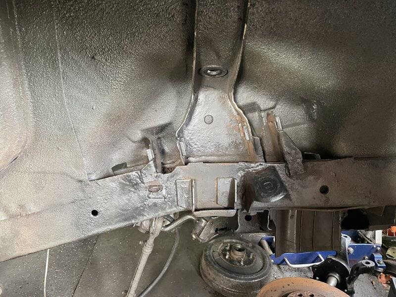

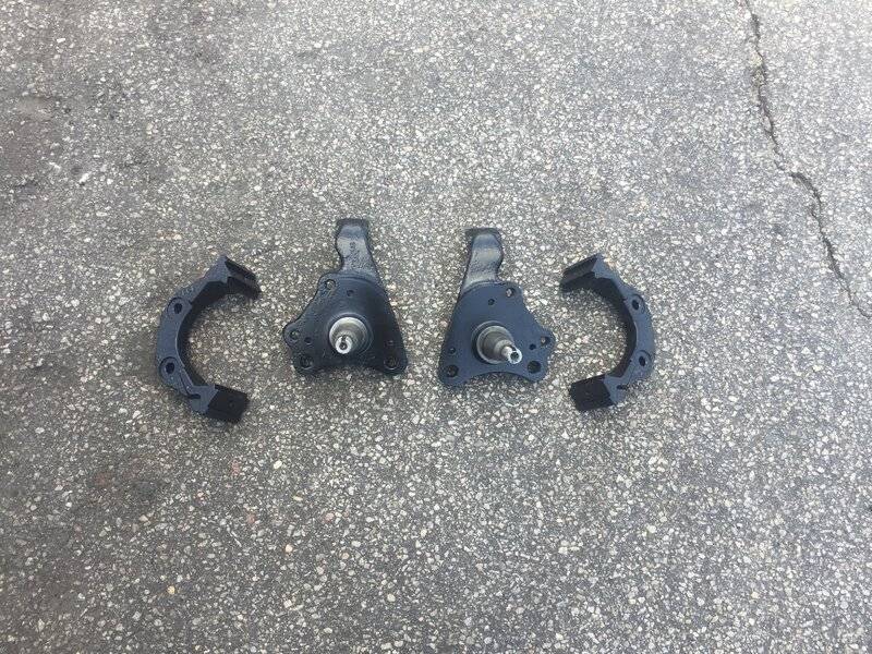

Next I pulled out the 73 upper control arms and spindles that I had picked up a few years back and cleaned them up for the rebuild (note I forgot to get a pic of the uppers). This will also convert my front end from small to big bolt pattern. In terms of the front suspension I came up with the following: All new Moog components for the upper and lower ball joints, Energy Suspension upper control arm bushings, and the PST lower control arm rebuild kit with new greaseable pivot shafts, bushings, stiffening plates, and torsion bar adjusters. I also picked up a set of Mancini Racing larger diameter strut rods with new Energy Suspension bushings and new washers. For the brakes, I'll run the 80's style caliper in the rear with the Chevy Camaro front brake hose. I picked up the 1.03" PST torsion bars for the ride & handling and a rebuilt steering box and all new tierod ends to finish it off. I’m interested to hear of others experience with this mix of components and anxious to get it back on the road to give it a try.
Now out with the old

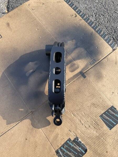

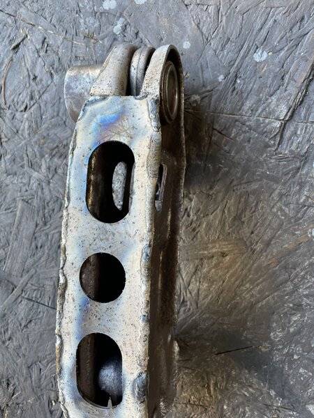

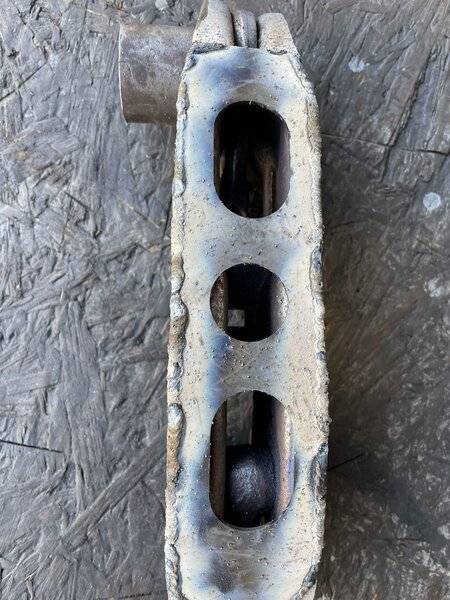

Rebuilding the lower control arms and welding up the stiffening plates....

Got the new bushing into the LCA with new PST greaseable pivot shaft and torsion bar adjuster:
Here is a comparison of the stock V8 torsion bar against the new PST 1.03"

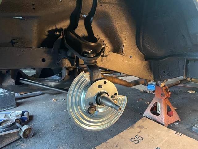

Getting things buttoned back up with the new balljoints, control arm bushings, and Mancini Racing strut rod:
Also picked up some new dust shields off ebay
Finally the finished product. Note I had to use a small die grinder and file to allow for the new brake hoses to go back into the factory location with the OEM clips.
Overall I'm very happy with the result. I only took one pic of the driver side, but the result was the same. I also left out me wrestling with my old hard crusty tires on the tire machine to dismount from the small bolt pattern and mount to big bolt pattern 14" rally wheels - for the sole purpose of keeping the car a roller (I destroyed the bead, but hey they're holding air!). I'm still debating using some 15" rally wheels or police wheels for the final finish. Still plenty of time though to ponder that thought. Next up is tie rods and then on to the rear where I have an 8.75 waiting to be cleaned up and installed. Any thoughts on the offset spring hangers? I'd like to get as wide a tire as I can in the rear without a mini tub or spring relocation kit.

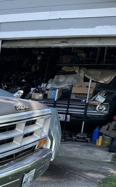

Hi all, I'm back after a very long delay. Fortunately, but unfortunately I have been pulled away from the Dart as required to complete my new garage. It's a 30x40 with 14' ceilings, a two post service lift and 2 four post storage lifts so looking forward to getting back at it. Already have 6 cars piled in and the Dart is still stuck in the old garage!
