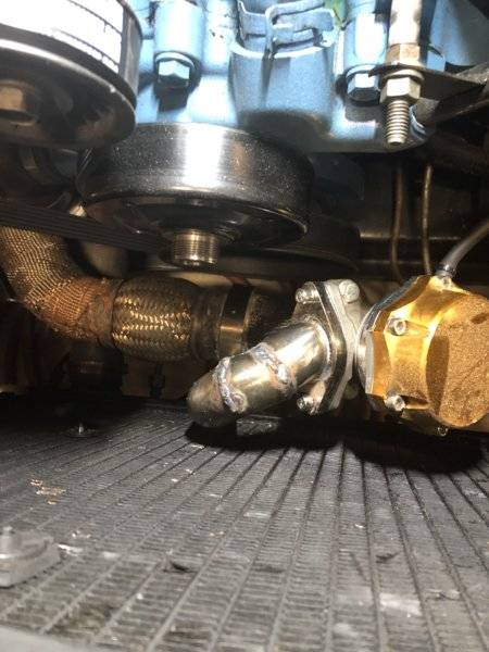

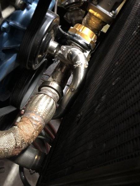

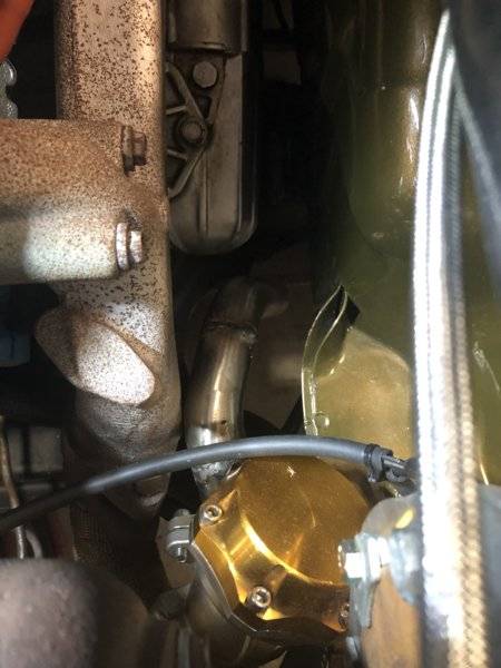

Update: I fabbed up some wastegate dump pipes last night. The flanges came with the wastegates. Used some stainless sink drain line from a lab. Works well and was cheap at $1.80 from the recyclers.
Pics for motivation or a good laugh. Thanks to my cousin for the final weld. Should have tig welded for a nicer look but I don’t care and you barely see it. Just looking for function and it will do that! Trying to get it to Rockingham on the 20th for the Mopar show. If not this then the turbo Truck is going. Either way I will keep those that are interested informed.
