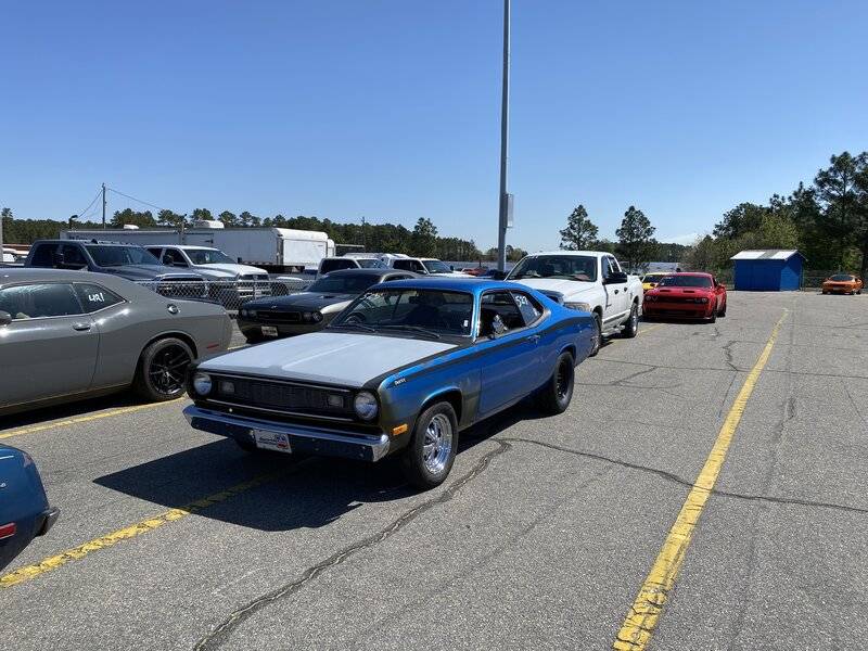

Went to the track today. Picked on a new 1320 Scatpack challenger. Overall car did great, could’ve done better, but successful!
Observations are as follows:
Need a better converter, this thing doesn’t foot brake that well. 1.83 was the best after bringing it up on the converter to 2300. Also going to investigate a 2 step so I can leave on come boost.
Need more boost! Limited to 6.5 psi even though I had a boost bleeder plumbed in. I will need to look at the gate pressure springs and see if I put the lightest ones back in!!!
Better shifter!! I column shift this thing and hit the rev limiter 2 times while shifting and missed 2nd and went to 3rd and then pulled back into 2nd.
Best time was a 11.72 with a 114 mph. More to come and I will try to upload the videos my cousin recorded of me.

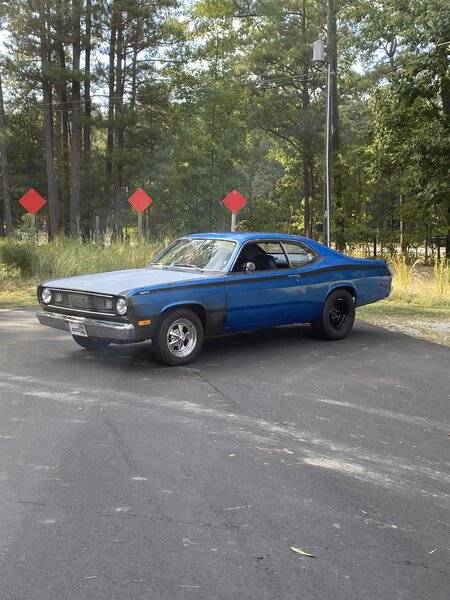

Anyone else drive there turbo junk this weekend? Cleaned it up and went for a long drive. Can’t do much test/tune until I spring for a new converter. We entering into “boost weather” in beautiful NC.
