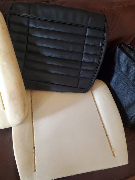

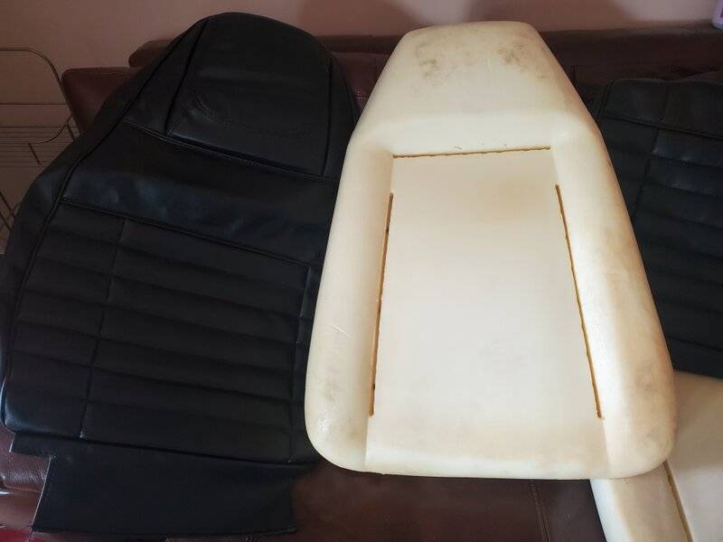

Here is my seat with the B body foam and seat covers from PG classics.
Jerry
Well damn..! Looks good to me..!
Did you have to alternate foam at all..?
That a HEMI car sitting there..?
The foams are perfect. You don't have to do anything to them.
