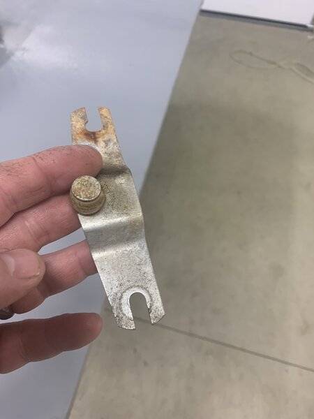

Does anybody have an old manual that shows how the door glass goes into the regulator in a 72 Duster? I bought the master rebuild kit with all the new slides as when I bought the car whoever disassembled it through all of the parts in a paint tray...

Do you have a bare shell and are looking to see how all the guts are oriented inside? I have a complete door with the front skin cut away for just that reason if you need it.
That is exactly what I need. If you can provide a couple detailed photos you just might be my saving grace.

Here are a few pics. Let me know if you need anything else.
This is very helpful. I have only one of these pieces and I assume I need two for obvious reasons. Can you look to see if it rolls along the rear vertical slide channel? Any idea what it is called?
Nope, just 1. It runs along the outside of the front vertical channel. Gets attached by the window bolts.
Correct. One for each door. I only have 1 total. I wish I could meet the person who disassembled this car. Hahaha
thank you for all of your help. I’m pretty sure you saved me.
