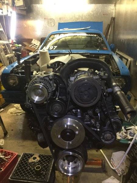

I would like to see more pics of the exhaust plumbing if possible. Are you running any type of intercooler. Once again very impressed with what you have achieved on a basically junkyard engine

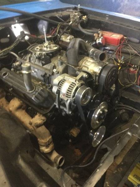

And more. The crossover evolved over time to better fit the lower radiator hose and electric fan. Then I had to move it all forward some when I changed to the QA1 K member.
That looks good. Thanks for the pictures
I'm not running any type of intercooler (I'm just not willing to cut up the car). My inlet air temperatures (inside the manifold) are close to 300°F at the end of a quarter mile run. I may look into meth injection, but I'm getting tight on room under the hood. I probably will not even try to put meth injection in until after I get all of the air conditioning lines run under the hood.
