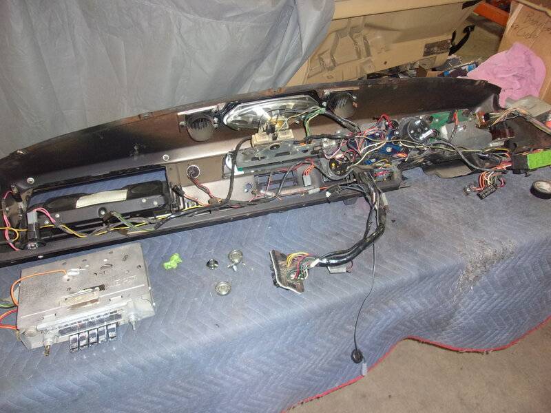

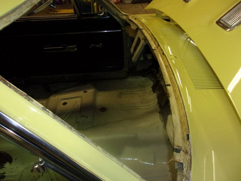

They bolt in but the windshield must be out
There are many different ways to skin a cat.. The preferred method is to pull windshield and unbolt dash at windshield upper frame, and lower knee area.
Preferred? Not for me. I don't want to tear the windshield out if I want to redo the dash. I pulled mine out and reinstalled new clips upside down, screwed in from the bottom, being very careful to nut use too long screws that damage the gasket. I first cut the old clips with a small die grinder and cut off wheel. A dremel might work. I pulled the glove box, heater, heater controls, and cluster and of course the column.
Not sure about stuff like factory AC, it would likely have to be removed first.
Maybe in the 70's and 80's. Now at age 69 I couldn't get my fat *** under there. After several windshields they get easy . Lots of Dawn dishwashing liquid both removing and replacing.
67Dart273 thank you for the very good pictures! Just what I needed to answer my question. Now to decide if I really want to go that far because my windshield is perfect. Have been the 'glass removal' route on customers cars and no more time than I get to work on my own project, I may just leave it and work it in place. Oldmanmopar: I feel you there. At 64 it doesnt get any easier standing on my head under dashes! lol
