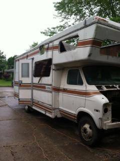

the 360 in my dart came out of a '76 sportsman aka tradesman van motorhome. It wasnt easy, and I had to get as much off as I could off the engine, and everything that is bolted on the front came off too, but it came out the front. The hardest part was you need to tilt it up as it gets close to the front opening, I had to tilt the engine upwards to get it out. Not impossible but they're might be better ways, the way it was set up for me, it was impossible to access the motorhome from either side, so it was the front or nothing.
A couple pics I took
I have taken the grill out....I got the radiator out...alternator...a/c compressor....
I power washed the motor and trans today...as it has been sitting for several years and the dust was caked on...
tomorrow i am going after the exhaust manifolds and head pipes with a reciprocating saw...and work on getting the trans out....
motor and trans headed to my 88 D250 that has a worn out 318 in it
thanks for the pictures...

I just pulled a 318/727 out of a similar unit and it came out the front with a lift plate bolted where the carb was and the arm of the engine as close as possible.I chopped the front lower crossmember out and it came out pretty much complete with exhaust manifolds,oil pan,starter,motor mounts,etc.
I did pull the PS pump,fan,and alternator off first but I probably could have left those on and still got it out.
If I may provide my $.02 worth, I have a '77 B200 van, and have had the engine out a few times. After you've done it a couple of times, you get pretty good at taking it out the front, and you can do it pretty fast, because all the stuff in the way can be quickly & easily removed. And IMHO it is a lot cleaner pull than taking it out the passenger door.

Cut out the cowl to fit the hoist and it pulls right out, that's all we had growing up was tradesman vans and that's how i got my first 318 for my old dart.
I just did this today at the pick N pull with a friend of mine. We got the 360 engine out of a ‘91 ram van. Took us 3 hours. Came out the front, it was easier than I thought it would be.
When I worked in a Ford dealership we made an adapter to replace the damper pulley on the front of the engine and ran a chain with a adjuster from the center of the boom to the front of the engine of coarse you had to strip the grill and radiator and the top of the core support off like your pictures show I have probably pulled 100 Econoline engines this way including 7.3 powerstrokes.
