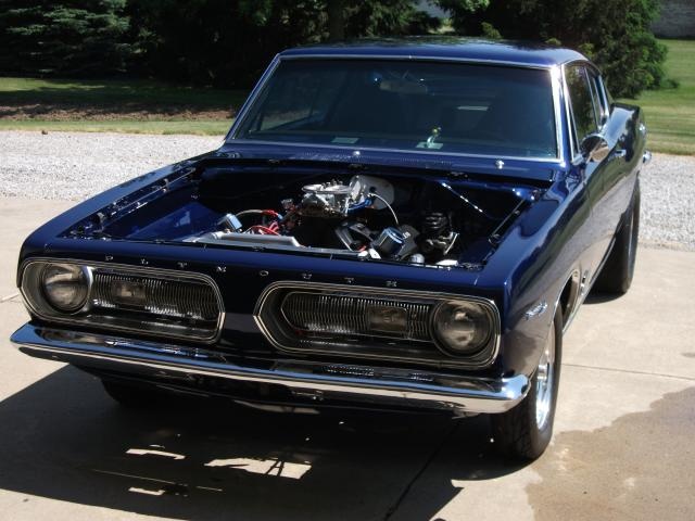

Thats a sharp challenger!!! Converters are VooDoo...what may be right for your engine will not be so good for another combination. I run an 8" in my Cuda, [440/Dana 3.54] It works really well. I have had it in the car for many years...trouble free. Wouldn't change it unless it broke...[Turbo Action] Just have fun...you will never figure it out unless a chassis dyno/drag strip is near by. And a few converter r & r's.
