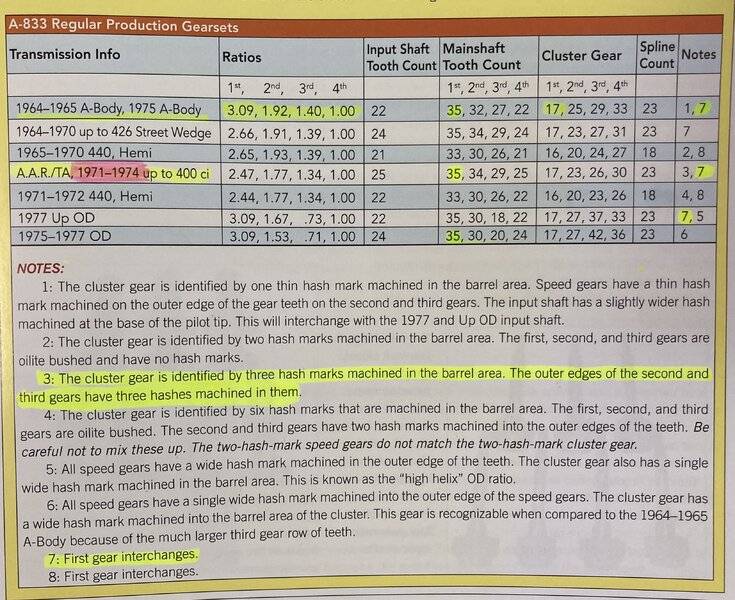

I am convinced, by reading @AJ/FormS experience and explanation, that I would benefit greatly from having a 3.09 1st gear and possibly a 1964 - 1965 gear set of 3.08, 1.92, 1.40, 1.
First off, I have looked at Passon's website and read his book but I am not quite finding what I need or not understanding. I'll list my current specs, the issues, options, and then desired effect.
1973 340 Duster, low compression 340, A-833, 3.21 (8.25). Numbers matching car so believed to be the stock gearing of 2.47, 1.77, 1.34, 1. The engine is a standard bore, stock piston, LD340, with a SFT 224/224 @.050, .470 lift, manifolds soon to be TTi steps.
The car is slow to get off the line and can't crawl. Its starting gear is 7.9 (2.47x3.21). I had mistakenly been thinking mine was a 2.66 1st gear with a 8.5 starter gear. I thought a jump to 3.09 x 3.21 = 9.9 starter gear would be pretty good. Now I know my '73 has a 2.47 1st the difference kinda makes it all that much more, almost, mandatory. 7.9 to a 9.9!
My cam is great. I love it and I'm not blaming the sluggishness on the cam. I believe this change will allow the cam to serve me in it's peak performance. I currently have a 3.21 SG 8.25 rear which is factory equipment BUT I do have a 8.75 housing coming together with a 2.94 Eaton True Trac diff and a core 3rd member for a 3.23. Switching to 2.94 isn't a huge problem for the payoff as I do intend to drive on multi-day cross country trips BUT I will also be able to put the 3.23 together for normal use and be close to my current 3.21 gear.
I would like to do the transmission gearing change ahead of a rear gear change so I will know how 3.2X feels with a 3.09 1st gear.
Is it possible to convert my VIN stamped case and put 3.08, 1.92, 1.40, 1.00 gears in place of the 1973 OEM gears? Is this limited to swapping 1st? What parts? Cluster Gear ?
So, I like a 3.XX gear for my area, farmland, 45-55 mph flat roads (3rd), 65 mph limit on state highways (4th), driving in parking lots slower would be nice. I like the economy of a 3.21 and 2500 rpm. Now, it does suck going 65 (2600rpm) in the 70-75 Interstate traffic. I am looking forward to using a 2.94 and going 70mph (2550 rpm).
No cam swap, no other cases or 5/6 speeds. I want to keep my VIN stamped case. I do also want to swap to the ball and detent side cover during the change out too. I'll be looking at the hydraulic Malwood setup as I have a disability in my clutch foot.
What do I need to do here? Just 1st gear available or can I convert the whole shebang to the early gear set? Let me know if I left anything out.

I'm no expert, but pretty sure you should be able to find an early companion flange 4 speed and swap the gears into your case without problem. Might need to swap the bearings, but I doubt it. And I would guess the side cover swap would require different forks, but nothing else (besides the cover).
The 3.09:1/1:1 gear set is functionally the same or close to the same gear splits as the Passon OD setup and people love those.
Pretty sure the '75 318 4 speed cars used a 3.09:1/1:1 gearset, too. So even the factory went that way.
I would find a complete gearset and swap all gears and the cluster. This includes the reverse idler.
When I had my A833OD apart a couple of months ago, I thought about swapping the 1/2 slider with another one I had and after some limited reading decided that the one I had and the spare were potentially different. There are markings, notches in the points of the gears and such, that lead me to believe they were different. Because I couldn't verify the reverse gears and idler would mess fine, I left things alone.
Thus, I would keep everything together. You will have less chance of an issue doing it this way.

the 64 to 66 six cylinder trans has the 3.09 gear set. , it drops in, don't need to change reverse gear either, i had a friend , changed to a 3.09, from a 2.47 gear set, in 1/4 mile it was two tenths quicker, the 340 will pull the split on 1 -2 shift easy. i ran the same in my 340 car, go for it,just food for thought
From Passon’s SA Design book book.
Note 7 says these are all interchangeable.
I guess the crux of it all is the 64-65 complete main shaft swappable?
I guess the crux of it all is the 64-65 complete main shaft swappable? View attachment 1716268441
Based on that, I guess maybe you only need the input, 2nd and 3rd gear and the cluster.
In regards the the reverse idler, I'm not saying it absolutely has to be swapped. It was only a suggestion to make sure a problem doesn't happen and the trans has to come out again. Makes sense that the reverse idler wouldn't change, but I know the parts trans I have had a different slider/reverse gear than the one that was in my good trans. But both of those were OD trans, and the parts trans was a truck one to boot. So, just a thought.
Front bearing is the same and same retainer? What I need is a core to play with until I want to pull my trans.
