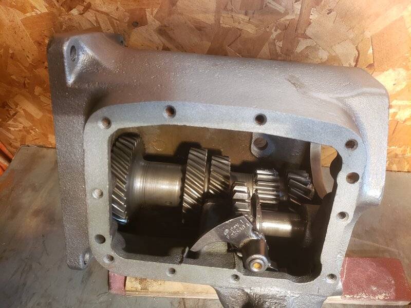

I'm building a 1965 B&T 4-Speed and I'm looking in the Tailshaft wondering if there is supposed to be a baffle in there at the top to keep the Fluid from Slinging out of the Vent on top. Am I missing a piece? or did the 1965 Ball & Trunnion Style not get one?
I did not have a baffle in my 65 B&T trans, I did get some very small vapors that did cause a tiny bit of seepage of fluid but not enough to say it would splash out. I got the car in pieces and the trans was partially disassembled when I got it, but never thought it should have baffle.
I have rebuilt several hundred of those A833s. Most had the baffle but not all.
I'd have to say that most of those that I built were Big Speed-O gear, boxes, 67 up if memory serves me; so that might have something to do with it.IDK
I hope you have better luck than me, getting the loaded M/S in with the cluster already pinned, and still having all the rollers in the back of the input gear where they belong.
do you pull the Cluster up after the m/s is in?
The 64 parts book does not show a baffle but I’ll check the service manual and my disassembled B&T transmission and report back later today.

The baffle is not in the 64 service manual but it’s in the 66 manual. I’m thinking it has something to do with the location of the vent. The vent on the 64 with (no baffle) is located at around the 10:30 location when looking from the rear of the tail shaft housing and on the 66 and up transmissions (with vent) the vent is in the 12:00 location
The B&T does not create the pressure that a slip yoke can and does.
66 was the first slip yoke and the baffle was used.

I would think there is not a "tremendous" amount of fluid sling in that area. The rest of the box is separated by the big ball bearing, and other than the speedo, there's not much to stir things up in there
