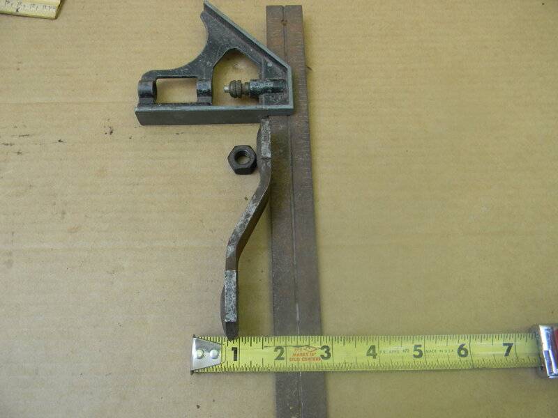

i have a set that came from a c body that has an offset but not schure just how much can measure if interested.
dont quote me but i think the most offset you can get is either 1/2 or 5/8 in reality. maybe someone else can verify

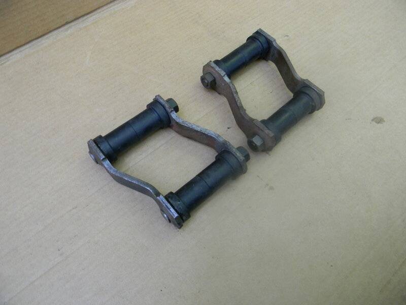

Did you settle on a shackle set because this is what I have available. Like new - installed & run a few times for a project that didn't work out.
