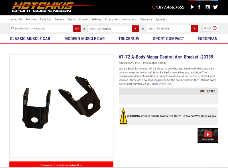

Can someone tell me what the difference is between 67-72 A-body LCA's and 73-76? I want to install sway bar brackets on my '74 (which did not come factory equipped with any). I want to buy the type you have to weld on because I personally don't like those bolt on "L" brackets that come with aftermarket sway bar kits. When I search for these brackets, I can only find applications for '67-'72. Why won't they work on 73-76? I attached a screen shot of what is available for purchase below. Thanks for any info.

Well, for one thing, that ad is wrong.
Pictured, are the brackets for 73, 76.
Which are the ones that they want to sell you as replacements for the 65-72 brackets.

The problem with that, is the stock location for a '73-6 sway bar tab is even more inboard than all the other years. It's almost in the center by the limit bumper.

THAT is the info I'm looking for cudamark. You have highlighted that there is a difference in the mounting tab location based on year. Thank you.
You're welcome. Your decision will be in part on which sway bar you use. If stock, you need the stock bracket and location so the links line up properly. If aftermarket, the brackets need to be attached in the correct location to match it.

I think the confusion with the Hotchkis tabs are because they are for the 22385 bar which is a hybrid of the '67-72 and '73+ stuff. It uses the '67-72 sway bar mount but the '73+ endlink location and arrangement so that that wider wheels and tires will clear the bar.
So the tabs are correct for a '73+ car, but they were originally available only with the '67-72 hybrid sway bar and probably carried the labelling from there when they were made available separately.
FYI, the 22385 bar has instructions that might be helpful for locating the tabs. No promises that is the factory location though.
