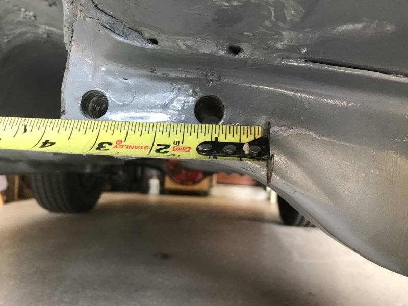

It WAS installed, car is blown back apart in preps to go to body shop. I crawled under there just for you to snap a pic. I opened up the drivers side a bit & drilled a new inner hole through the cross member and bracket. Camera angle is funny, but it’s close to 2-1/4 from the outer hole.
I was at the junkyard today pulling Liberty brakes to try the Mopar Action rear disc o tech swap down the road.
Had the block & trans in. Trans was hitting the bracket on the drivers side, & everything looked askew. Measured to get front of block and tailshaft offset the same amount between the frame rails, rough guesstimate how much needed to be removed, made cuts & retried. Can’t remember if I got it right the first time, (probably not) but got everything to where I think it needs to be. Front of block and tail shaft measure straight, and eyeballing down the tunnel looks good.
