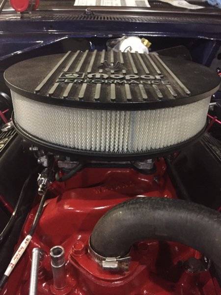

Mancini Racing Use there drop base with a OE/HP housing and filter. It also allows the MP ribbed unit to clear. I used this Wix filter pictures below. This filter is taller than the stock one by a little bit. It is possible to go a little higher. I found this at Summit Racing. They have a good search and to find the filter you want. Also odd diameters for the odd diameter MP filter housings.

Your air gap is going to create some issues for you. At least on my 68 barracuda it did. It is a bit higher and that creates hood clearance issues. Also the stock throttle cable bracket needs attention if you are using one. You can get a dropped base cleaner that will worK with pretty much any lid you want. One other tidbit you probably won’t need to know. If you go with the un-silenced 67-69 air cleaner housing at about 340 rwhp they become a restriction. You really only have about 5/8” gap at the bottom for air.
