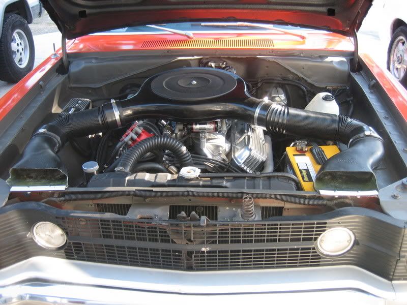

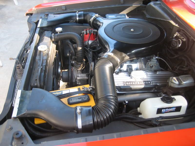

This is the RamAirbox system in my '68 Dart GT with a 383 Big-Block.
Hood is from a OEM Dart GTS.
Carb is a Holley 750 sitting on top of an Edelbrock Performer RPM manifold. There are no clearance problems .
I got the "Ram Air" kit purely as a Cold Air Induction system. It works well.
The difference was noticeable. Acceleration response was increased, and in fact the car felt, immediately after the retrofit, as any car acts when driving on a slight downhill. It just went slightly farther with less effort at the Accelerator pedal

Very cool setup.

I thought about running the system that way originally, but then again, I had a "space" problem running the Ducts down under the bumper...I don't have a lot of room in the engine compartment with a 383 in a Dart..the ducts are 3" diameter and I didn't want to flatten them..
Also, the longer length needed for the ducts, plus the extra bends needed on those same ducts would negate a lot of the gains...Supposedly you lose about 25% of any initial gain for every 90 degrees of bend...
And last,with my car being a daily driver, I was worried about feeding a lot of road debris into the carb.
For me, it just made better sense to place it where it is..
If it was a Race Only car, I'd pull the headlights and run the ducts there.
