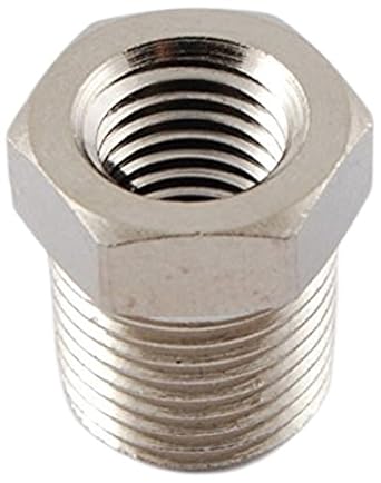

Ok I'm using a air gap intake and was just wondering how everyone is using a aftermarket water temp gauge on them. Seems like it won't fit in the opening on intake like it's to small..any pics
Open the hole and tap to 1/4 pipe thread, then bush it back down to 1/8..
well - there are adapters available - a little hard to source the right one but it can be done - or, Edlebrock (or some other maker) water pump and do this -
mine is right by the return spring bracket in this photo...there is an adapter that make it work..
