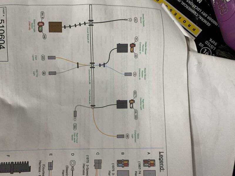

All,
Thanks in advance for your help. Currently working on re-wiring a 1968 Barracuda with the American Autowire kit. When trying to connect the wiring for the heater, the connectors are different sizes. I tried to contact American Autowire about it and although they were very responsive for other issues, I did not get a reply for this issue. If I can help it, I really do not want to use the original harness and keep it with the car with the original parts. Is there a way to purchase an original male connector so I add it to the American Autowire harness or any other options out there?
Thank you.
Swap the connectors? This would leave your old harness intact. Maybe put a piece of tape on it with a note that it was swapped so you'll remember. Then maybe you can source another OE connector later. Buys you some time anyway and you can keep moving.
I have a donor harness, if you can post photos of the exact connectors you need I might have them.
If I have them you can have them for shipping.
Thanks for the offer. I did order a male and female connector from the other link above but if it does not work out I will be sure to reach out.
Looks like both the grey and blk connectors have female terminals? You could make 3 short jumpers with male terminals. I probably have the grey mating piece as well? What are the terminals in the black connector?
American Auto Wire used my 69 Cuda to make their harness but I don't have a heater hooked up. I'll look and see what's on mine. But swapping the connectors are easy if they use similar terminals. Just use a very small flat blade and push it inside of it to slightly bend down the tab inside. and pull it out then push it inside the old one. I also have a complete wiring diagram if you need any info.
See the small slots in the end of the terminals, that's where you push in the blade.
Looked at mine and it's a 2 terminal T. It doesn't look like yours. But remember it was the first one made. It may have a 3rd one but I couldn't get up under the dash right now. Sorry I couldn't be too helpful on this.
I was wrong on the connector. I took a better look today as I was cleaning up the barn. It needs a jumper and I don’t know if I even have one for it. But here’s some Info, hope it helps.
