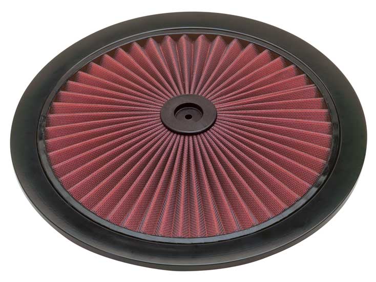

3)K&N's X-stream air flow top- they make them from 11-14" in diameter. it's basically just a filter for the top of your air cleaner, like this:

11) throw your rubber foam on around the K&N top, or around the hole you cut, so it seals around the rubber edge of the filter. working fresh air system!

k&n claim their filters are damn near water proof......emphasise on the word claim though
They are not. I've been stuck on a motorcyle with K&N's in a rainstorm before. They absorb water and restrict airflow to the point of killing the engine. It doesn't matter how much or how little the filter/s are oiled either.
yeah, that's why i think the best idea would be to get some foam and put it in the intakes. i'm actually coming up with another system, that (i hope) would be cable operated, that does what the air grabber hoods did- shut out the scoop and draw air from the eng. compartment.
