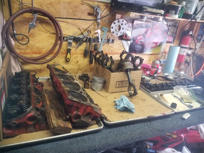

Hello All,
In the midst of the teardown and I have a few questions.

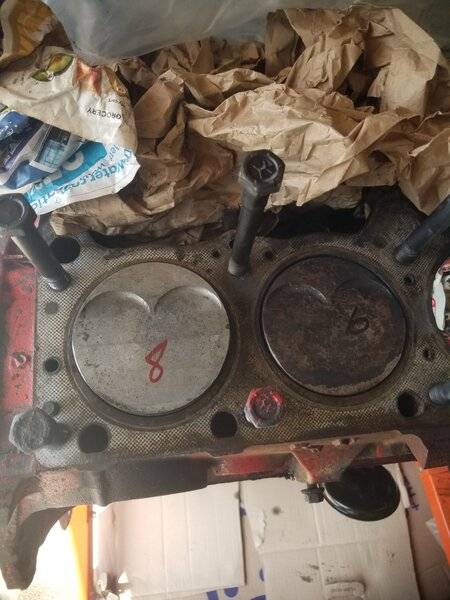

1) Piston #8 has a few light scoring marks near the top of the side of the piston. Looks like it might of sucked something in. The cylinder wall shows no damage and neither does the valves.
What do you think this is from?

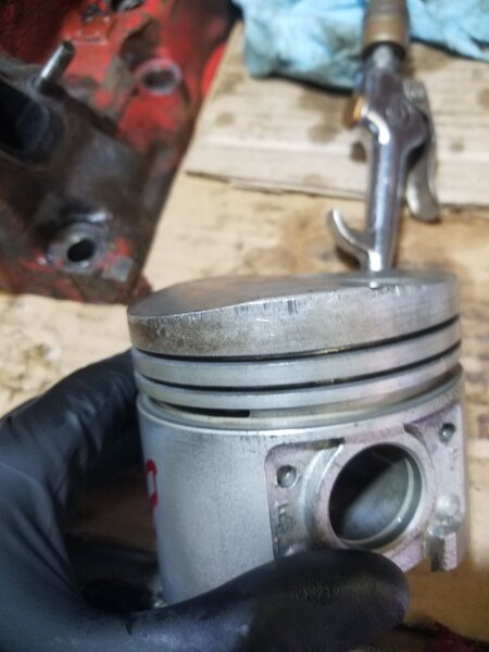

2) I have been using the Berryman gallon carburetor cleaner dip to clean the pistons. It works ok, but not too the cleanliness that I'm looking for.
Any better ideas to clean the pistons?

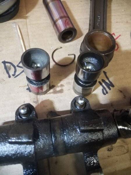

3) I initially thought that the inside of the block and heads had a lot of grime. But it appears that the castings on everything from the heads, block lifters etc. are really rough and look like grime. I posted below a picture of the inside of two lifters, one cleaned and one dirty. The casting marks a really rough as well.
Is this pretty common?

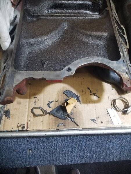

4) The firewall side of the intake manifold's sealing edge almost looks like the casting broke off.
Is this lack of the metal surface being present going to be a sealing issue?
Thank you in advance.
if no damage anywhere else, i'd guess carbon build up that broke off and rattled around in there. dress the rough spots and ship it.
media blast, but that's a dangerous game. maybe an ultrasonic cleaner with an aggressive cleaner but tough to do with aluminum.
yeah, looks normal.
it's not broke. sometimes they just look like that from the molds. it'll seal up fine there's plenty of meat.
ETA: if you're just doing a hone/re-ring/bearings & reseal on the motor, i think that piston looks plenty clean.
If you want to dress the casting to be more eye appealing go for it.

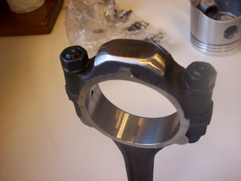

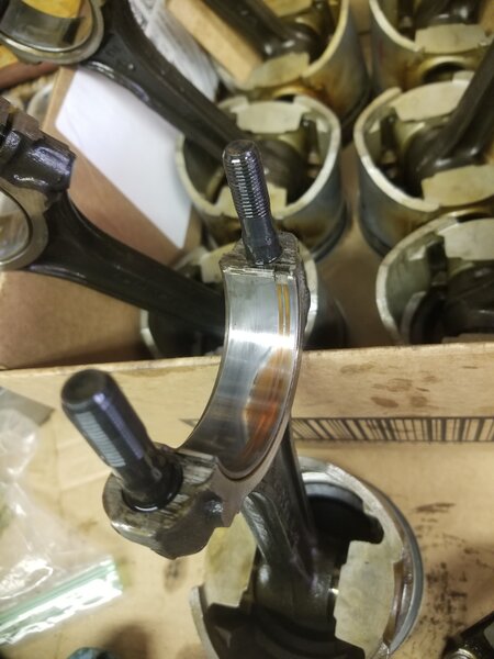

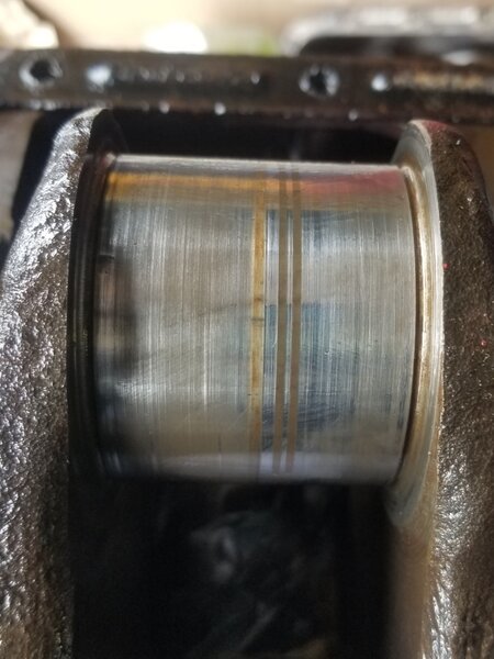

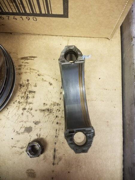

Below is a picture of #7's rod bearing.
Pretty strange wear marks. Debris or something must have got itself in somehow?
There are no ridges on the crank journal,
I'm hoping this can be polished away?

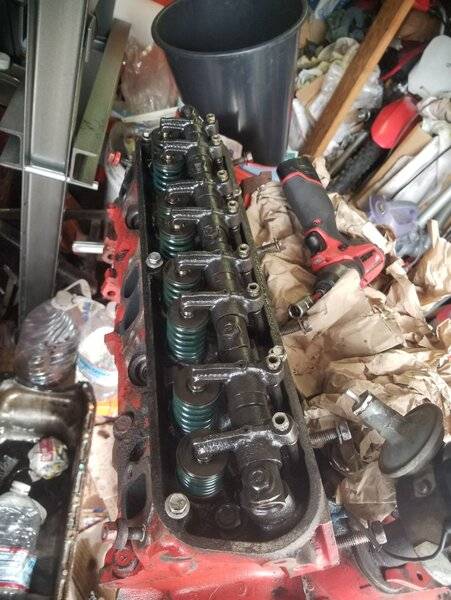

It appears I have different sets of valve springs on each head.
I have green on one side only. Anyone know what the green color valve springs are?

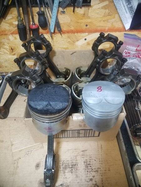

Piston cleaning came out good, seven more to go.....
Debris must have got itself in somehow?

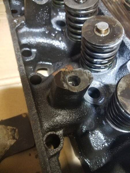

I would recommend checking the crank out. It may need a polish or may be a turn. That's not normal wear. May be check the rods too.

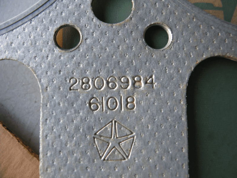

I picked up this Old Stock OEM Head Gasket set for the 273.
Part number 2806984.
From what I read, these will work on the 273 and are close to being as thin as the original 273 gaskets.
Comments please on using this head gasket.
Will these work and not lower the compression?
Thanks
Thanks
2806984 head gasket has a 4.01 bore and is about .031" compressed thickness at head bolt torque of 85 ft lb, .3915 cubic inch volume, about as good as you can get for a 318 or 273 anymore. I would not use those steel shim intake gaskets though.
