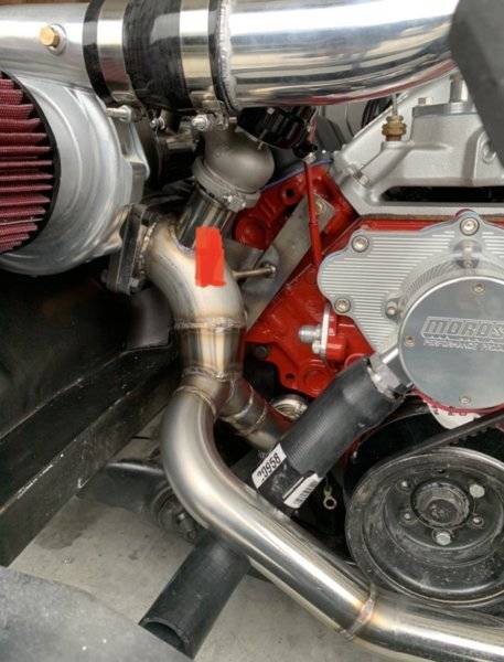

How are you logging boost pressure? I would verify that whatever sensor is measuring 23.5 psi is accurate for starters. Matts440 is correct, you need to give more priority to exhaust flow through the wastegate and even that might not be enough. You may also need a larger gate. And at that boost pressure I would look at the headgaskets first hopefully your problem is there and not crack in a cylinder or head. Good luck. Keep us updated.

I agree the wastegate mounting isnt ideal, studying my photos it doesn’t look as BAD as I thought. I do think it would benefit if it was placed where the red line is in the picture. (Please I know my editing skills are on point).

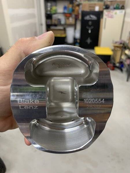

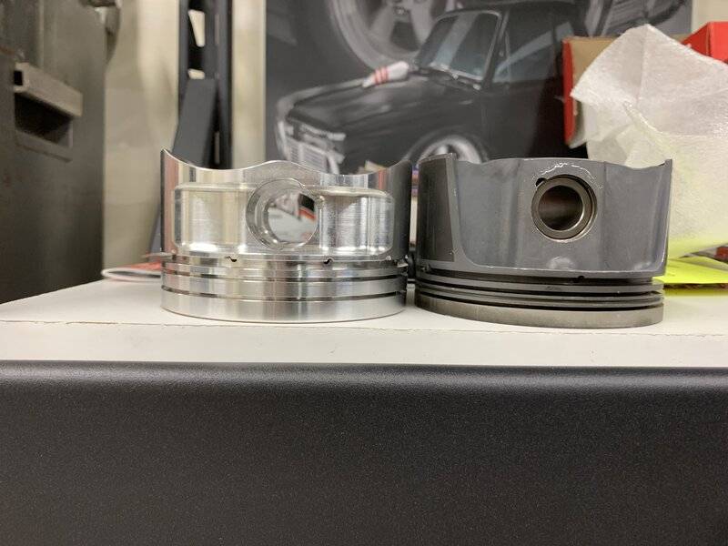

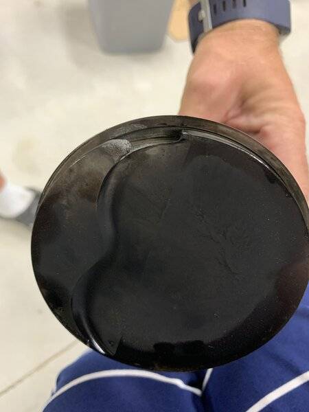

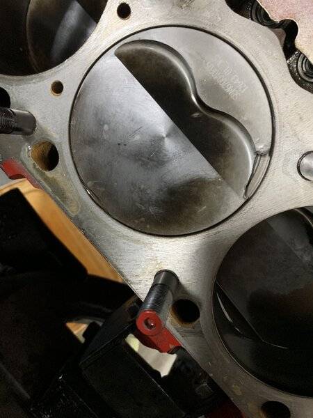

Ok guys it’s been quite some time, I’ve been getting a little work done on the valiant. I pulled the passenger side head to find a bad head gasket and a couple pistons that didn’t like all the detonation. ‍♂️ I put a different gasket on it and back together just enough to drive it on and off a trailer for our move out of state. We barely got all our boxes put away and started pulling the engine out. Had a couple plans to get it back together on a budget and beat on it without concern but they didn’t work out. At this point I’ve started a new engine build with a Molner stroker crank and custom pistons, finally got the pistons Friday so I can drop it all off at the machine shop for them to get going on the engine. I hope to have it back together to enjoy a little before the weather hits here.

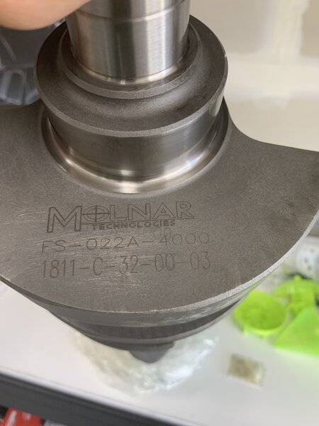

Agreed it was definitely an expensive learning lesson, there was many things working against me and my inexperience didn’t help. It did escalate quickly on the build lol. Well I realized the crank I was running was turned and 20 under and I didn’t want to run it, so with no luck finding a standard used crank I started looking at a new crank. It started with a scat 4” cast crank it was cheaper than the stock stroke! Only by like $10 lol. I was able to catch Racetec before they started making the pistons and was able to change the stroke. Then I got to thinking and decided to pull the trigger on a forged crank. I’m going to look into a second wastegate and placement. I’m also going to put a 3lbs spring in and just drive it a while before I make much boost so I can get the tune dialed and such. Also got a meth kit to put on and help with temps till I can find a place for an intercooler.

Ring gap, ring gap, ring gap. I can’t preach it enough for a turbo car. The damage you saw was likely caused by heat generated by detonation, and the rings butted, stuck to the bore and snapped a land. Open them up on the new engine or it will happen again.

Would you recommend using the piston manufacturer gap or a little more? Do you have a suggestion on how much gap?
