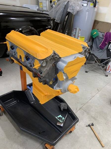

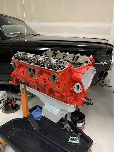

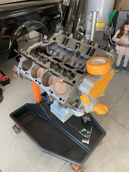

Well I got the short block back and have made some progress while I wait for the Gerst suspension to show up. Working on fixing a couple things sense the initial build.
ended up going .028 and .030 can’t imagine it going further than 18psi sometime down the road.

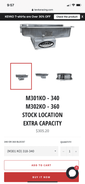

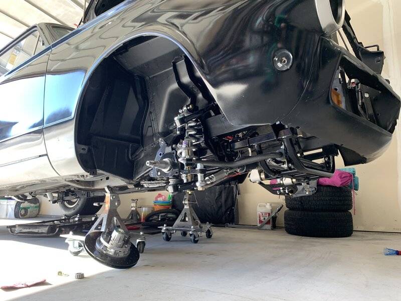

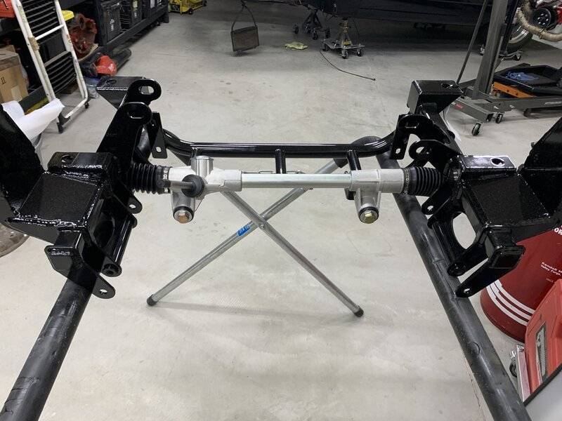

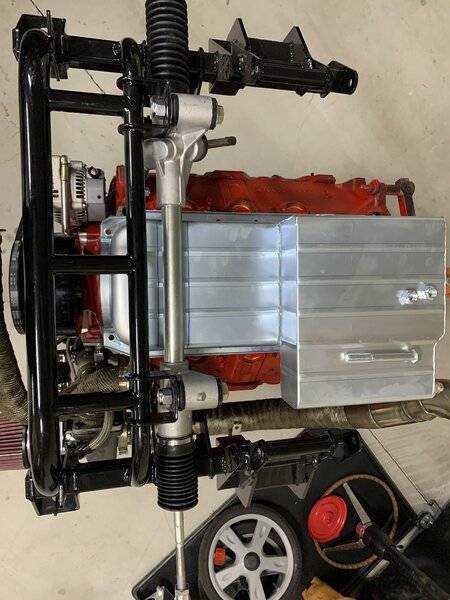

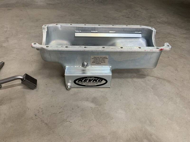

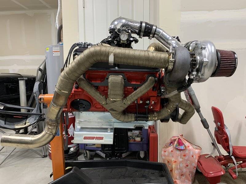

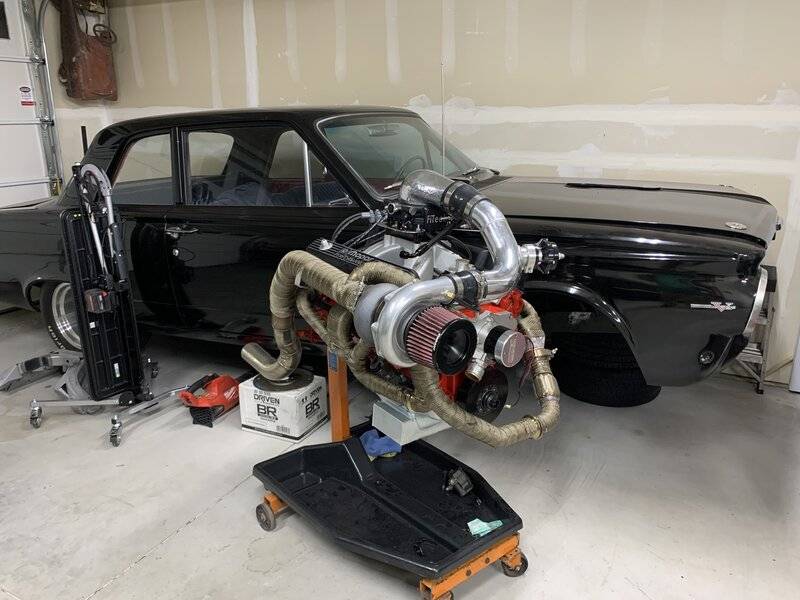

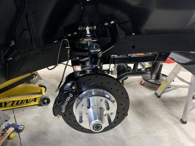

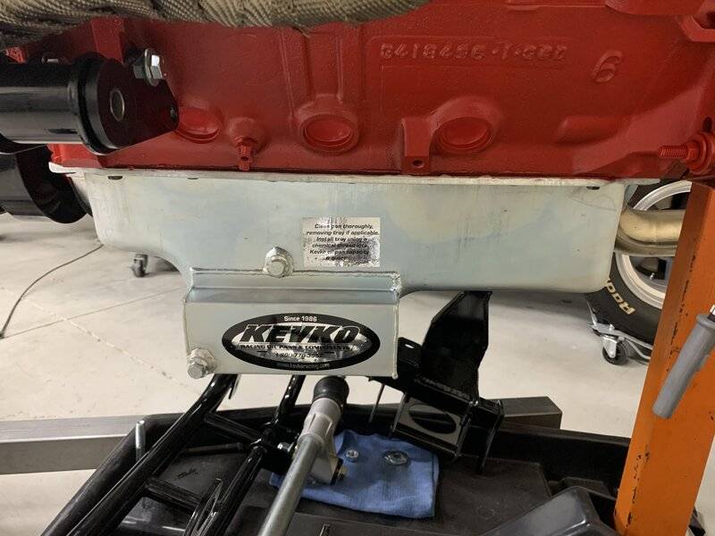

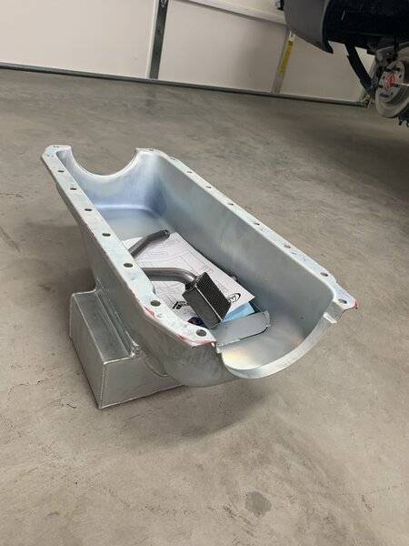

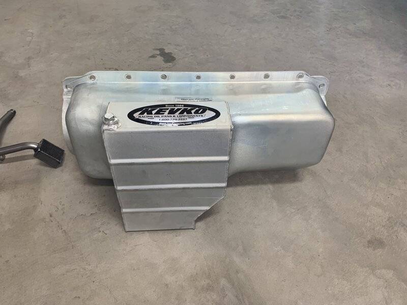

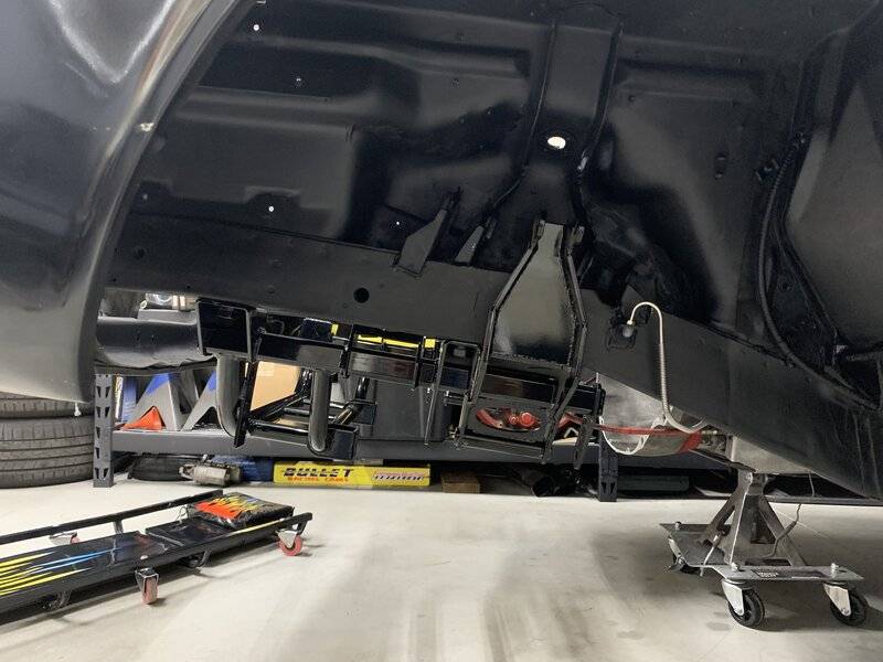

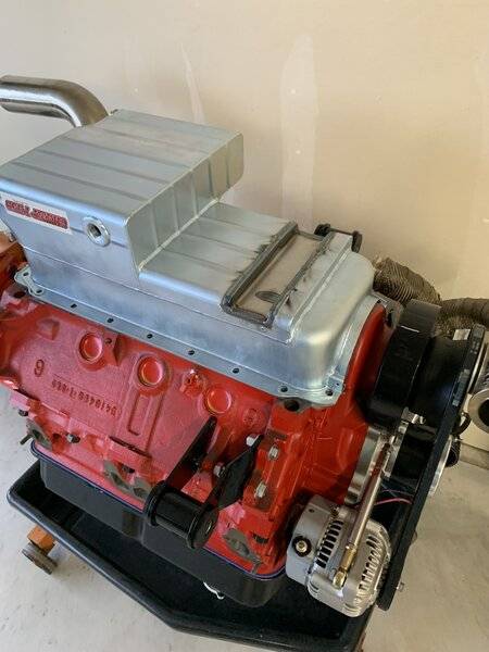

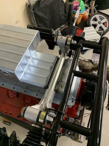

Ok, just in time for the 3 month update. It’s still not running. Lol. I received the suspension late December, between work and holidays and my crazy schedule I’ve finally got it all together and in the car. Overall it looks great, I’m sure (hoping) it will perform just as well. There’s a few items I would probably change but I’m satisfied with the product overall. Currently waiting in a B3 geometry kit to be able to measure and order pushrods. I’ll work on getting the engine placed in the car and start buttoning up things under the hood. I had some issues finding an oil pan that didn’t need a ton of modifications to clear the rack. I’ll post a few pictures that I captured though out the last couple months. Also if anyone is interested in a new Kevko oil pan I’ve got one I need to send down the road.
Been thinking about a road race pan, but need to buy a flywheel and some other stuff so not sure i can swing I yet. Let me look up the pan and think on it it.
Nice thing is, you are local enough we could skip shipping. :D

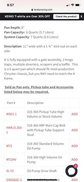

Oh that would be awesome! Lol I hate shipping stuff. Here’s the details on the pan, also I travel to Pasco and Wenatchee fairly often.
