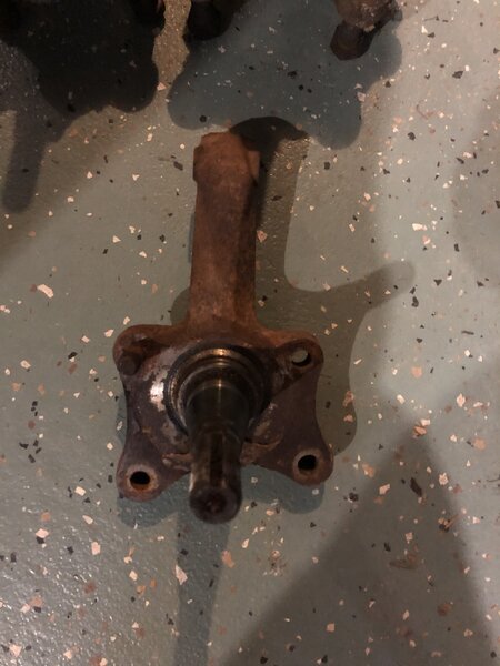

I have this spindle. I believe it's for drum brakes? I'm just not sure how to tell if it's what you need, 10". I know the car it came off of had a wilwood brake set up on it. If its what you need, It's yours if you pay the shipping. The car it came off of was a 68 dart, 2d post car.
Carl
That's a 9" inch drum brake spindle.

It is actually called a "knuckle". The spindle is the part the rotor rides on.
Most people incorrectly refer to the whole thing as a spindle when in truth, the spindle is part of the knuckle.
