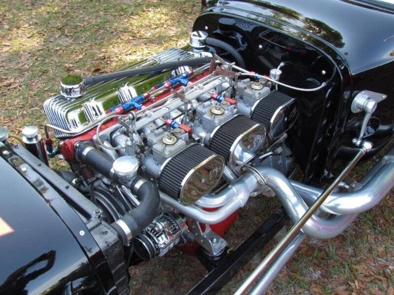

Different breather arrangements without pcv. I like the cover you have with a single push-in and plug the pcv hole.
I posted these a few years ago. Pretty sure if you keep an eye out you can find one of these.

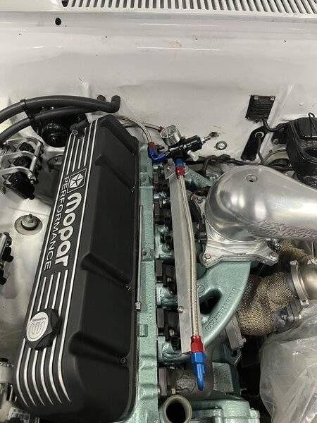

got mine from BlackFlag? was shipped from Argentina. have to use allen bolts on it ( no room for a standard bolt ) and its a PITA with the heater hoses right there. Maybe I will figure out a different routing for them at some point. ended up drilling out the cover and fill cap for a couple AN vent hoses when I started turning up the boost. the rings in the current short block never seated.
