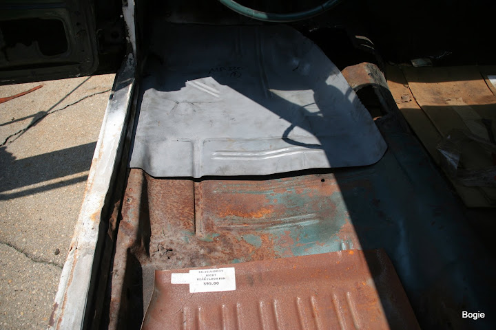

Is there any truth to what I read about the 67-69 cuda floor pan being the same just 3 inches longer? If so that would help me alot. Has anyone done this yet ?
http://www.autobodyspecialt.com/
I know they are two different numbers. I read somewhere that they were the same width just 3 inches longer and if you cut them down they would work.
the 1963-66 are Longer, than the newer ones.
They are reproducing the 1963-66 ones now.,Thats why I linked, and copied the pages from Autobodyspecialt :)
The sizes are in the gif posted. :)

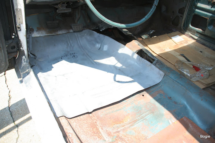

The latter pans can be made to work but the correct pans fit very well with minor trimming. I had to use the latter rear pans and it took a bit of work to get the shape correct even for a patch.
More Pics
