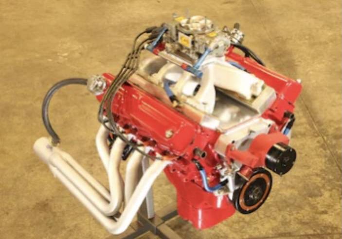

Stock stroke or 4" 360 LA crank? Either way, that's badass.
Any info on that S-Charger or those nifty header adapters?
Not stainless steel but tti makes headers for poly 318's
Wonder "what" that intake is?
Most likely the header adapters are from Toth Performance- first gen hemi 392 flange to poly port.
Best guess on the intake manifold is Chebby LS- same port spacing, and have seen LS EFI manifolds adapted to Polys, just never seen a blower setup before.

Love how that fitted the air cleaner setup on the super charged motor. But it does make a very tall step-up which is ok for a truck.
