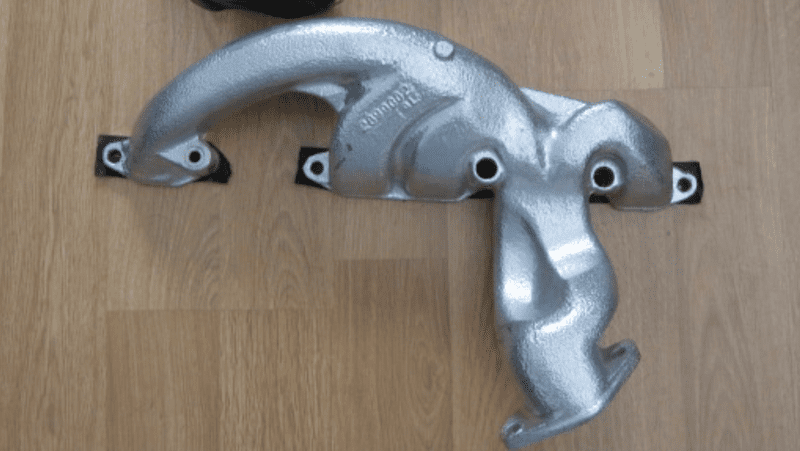

Considering these to swap a 383 into my 69 valiant. Are they better or worse than the originals ? I am open for suggestions on why I should or shouldn’t use these. Motor will probably be 400 horsepower. I’m not buying tti headers. Thanks

That's a good price considering what some of these delusional people are asking for their 50 year old stuff. Id buy new.
I think there may be some fitment issues with the drivers side B body manifold in an A body.
No problem with '68-69 B-body manifolds on a B block. A little more issues with an RB, but they'll still work.

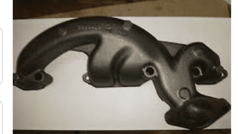

That’s a nice C body manifold. Is that yo?
Not mine Kim. I just googled “Mopar A body big block left side exhaust manifold” and that was one of the pics.

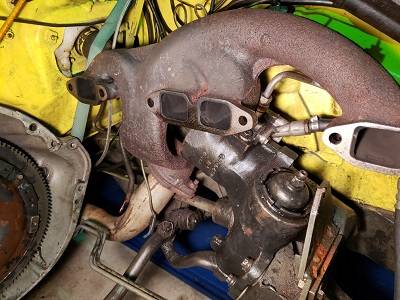

A few years ago I dynoed a motor with what was supposedly a set of the correct ones on it........ but didn’t really remember what it looked like.
More searching turned this up....... I don’t remember the one on the dyno looking like that down around the exit........ but it may have.

Ya thes factory A body ones are choked off pretty good. The right cam choose may help, that is if a guy can find it. Kim

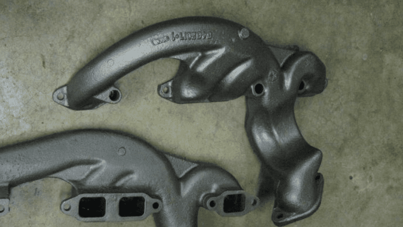

This is how a remember the one on the motor I dynoed looked.
A little different where it’s relieved for the steering column.
I guess it’s just a different year.

Use the B body HP manifolds> the C bodies dont flow as well and the originals Are $$$ and will cost you about 10-15 HP. Cut the column back as shown, cut an access hole for the #6 plug and you in business.
