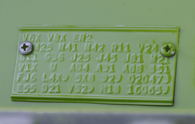

I'm thinking that if you can feel the tag when you put your finger on it, it is probably actually there but yes, I'm also curious as to what is fake about it?
Tag is a fake for sure. But that is the least of your worries. I see more issues that I wouldn't know where to start. Run away. Or you'll be doing a complete restore in time. Shine is skin deep on that body work. Even the grille looks like an ocean and the wing is a sagging after market junk. Look close at the trunk alignment and the wheel openings behind the chrome. Damage and patches just covered bad.

I think the exterior pictures are way to grainy to evaluate bad bodywork. One would need to actually move around it or have known horizontal objects reflecting off of it (much like paintless dent removal techs use) to declare it not straight. I do see potential issues but again one would need better pictures or be able to observe how reflections react to movement of the lens to say for sure. I'm still trying to understand why the tag is fake? Does it not match the VIN plate and how would anyone know that without seeing a picture of the VIN and its rivets? The last 3 number segments on the bottom line is the VIN and should match the VIN on the dash under the windshield. It is possible to reuse the pentagon rivet heads, so even if it matches, its not 100% proof that it is legit but it would be pretty likely. Again, how can you just look at a fender tag and 50' photos and say it is fake??
Okay- the tag is fake——- but how can you tell? That’s what we are asking. What should we see that you see to say “it’s a fake.”

Here is a picture of the tag pre-repaint from what I can find. It looks decent, but some older fakes can look convincing. I haven't accused this tag of being faked, but I too have had my doubts after looking at it. The font looks good, but if you look closely, the text characters are out of alignment in multiple places (examples - "VS29", "929", "020473", "160659", etc.). However, not all tags were perfect and the typograph could make mistakes from the factory - these alignment issues look fairly consistent? You could argue that the bend isn't pronounced and there may or may not be an inspector's stamp hiding under the paint.
From what I know about the car, the radiator core support VIN body stamp is missing. I was hoping to find a previous owner or someone who had prior experience with it that might have verified if the VIN body stamp on the package tray was still intact - but there is no way of knowing at the moment. Some care about this and some don't; I personally do. The car retains its torque boxes as it should with these options and the drivetrain supposedly matches. My biggest fear is that this car has had these options added or rebodied to some degree.

The way the letters and numbers are aligned it enough to know it didn't come from Chrysler. Many other clues but like all people who know how fender tags were made and hung we don't want the fakers to know more than they think they know...

I’m still curious what is telling sign that the fender tag is fake! Is it the misalignment of the letters and numbers or are there more clues?

I kinda am too, but if those two guys say it's fake, that beeotch is fake. They might not wanna give away their trade secrets. Can't blame um for that, but I'd trust um. You've seen how many Mopars @Oldmanmopar has torn apart and put back together on here......and that's just the ones he's shared on here. Yeah, he knows what's goin on.
There's another tag guru on the B body side that won't tell his secrets either, but from his other posts you can tell he knows 99.99% what went on, so I trust him that 99.99% plus the .01 to spot a fake tag.
