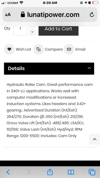

I am hoping a grind closer to this will clean things up.

I see 274/[email protected].
Nothing stands out to me as a problem with the numbers on the card for that application.
The pic isn’t all that clear, but it looks like there’s a spec for duration @.016, which looks like its hand written in...... so I’m wondering what the significance of that lift point is with that cam?

Unless the current cam has some odd issue, the Lunati 711 doesn’t look different enough to affect the change you’re after.
Keep in mind the lift specs for the 711 cam are assuming 1.5RR.
Keep in mind the lift specs for that cam are assuming 1.5RR.
Oh crap! Thanks PRH, my bad and good mention for the rocker ratio and lift stuff.
