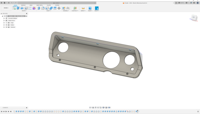

If its the flat speedo then its more than a bit... its a **** ton of modify to the dash frame to get the one for the later cars to fit. Personally I 3d printed a new dash, it fits and gives me 8 gauge openings.
I have this one, plus also I dont have a 3D printer.
Oh yeah no, that's the larger style opening compared to the one in my winter. The original speedo is like 1.5-2" tall and went across the dash.
Yeah when I bought the car I was glad it had this type over the other like my Dart had the one like you had.
Would you mind sharing the model file for the one you printed? Step file if possible, I've been working on one myself, but it keeps getting pushed to the back burner whenever something else comes up.
I put nut certs in for the top bolts and use magnets for the bottom. Had to print in two pieces and used Acetone to fuse it all together (printed it in ASA). Ended up taking 50 iterations to get things to form around the headlight and wiper switches.
