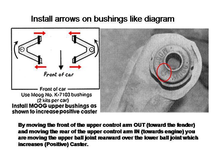

Are these Moog offset upper control arm bushings installed correctly ?? (A Body )
Brooks James
VET, CPT, Huey Medevac Pilot
Dec 12, 2020
5,487
3,654
Fruitland Park Fl
I read posts about them but I'm still confused
Are they installed correctly for "WHAT" effect?
Can tell much by the pics posted but if your installing them for more caster the front bushing arrow needs to be pointed toward the ball joint and the rear bushing arrow pointed toward the inner fender.
