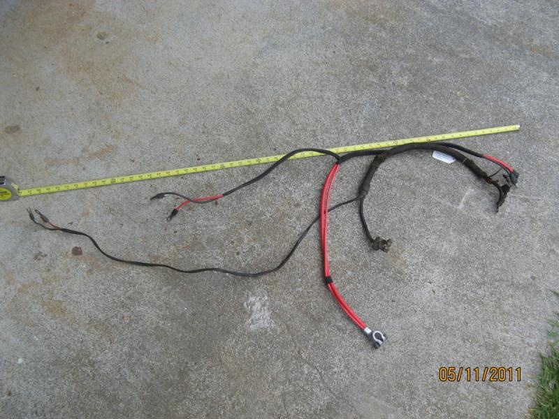

When the cables arrived, while initially impressed with the look of quality, I was disappointed by the absence of the protective insulating cover (black woven material) found on remains of my original positive cable. I am not a purist and I don’t show my cars, so I accepted these supposedly show quality correct cables with a grumble and set them aside for almost two months until I was ready to install them.

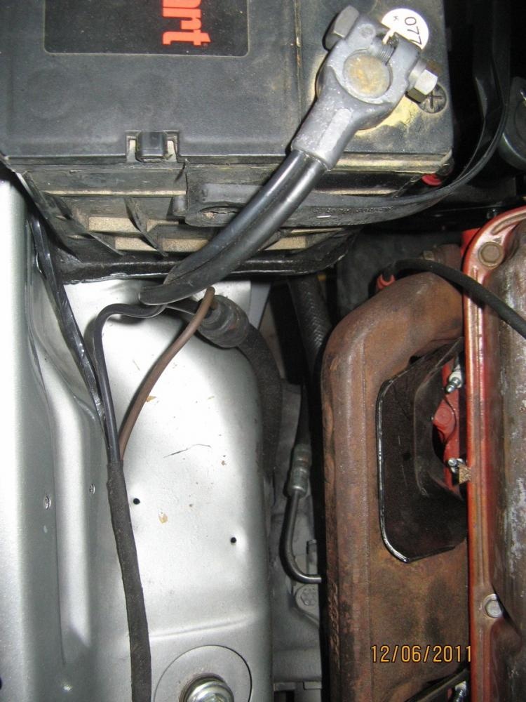

Now, back to the battery cable……the old cable was routed from the starter forward to the front (radiator side) of the shock tower and up to the battery. The repo cable, because of the length and location of wrapping could only be routed behind (firewall side) the shock tower and then to the battery. I debated with myself and was almost convinced to just leave like that until I referenced my other 3 Barracudas. (now I own a 66 to restore with it’s parts car and the 65 parts car) All 3, plus looking at pictures of other cars showed the cable routing in front of the shock tower, not behind it. My “show quality - will not be disappointed cable” didn’t look right nor fit correctly and too expensive not to. But there seemed no other option.

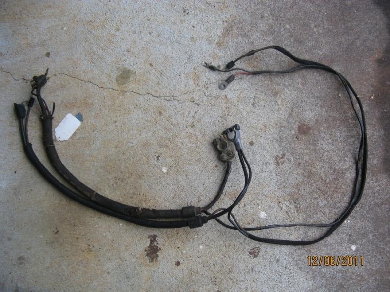

My 66 parts cars had an original, beautifully preserved positive battery cable with part number 2661913 clearly stamped on it. Problem was, M&H had no record or spec sheet for that number, the part number is not found in any parts book and an Internet search produced no results. (part number 2587819 is listed in my 1966 parts book for a positive cable)
In the end, I sent my 2661913 cable to M&H, they reproduced it and we worked out a deal where I gave them the cable to keep for future reference. So if you happen to want a nicely reproduced positive battery cable for your 64-66 A body, call Robert Wallace at M&H (562-926-9552) and request cable 2661913 using print 35225 (their in house spec sheet number). It’ll cost about $100.00 plus shipping and you buy it directly from M&H. YearOne is M&H’s exclusive distributor for wiring kits, but not battery cables.
In the first picture below, you can compare my original cable with the "you will not be disappointed" cable. Very different
Second picture compares my old original cable with the new one from M&H. Nice match
Third picture shows the M&H cable routed in front of the shock tower and near the battery.
