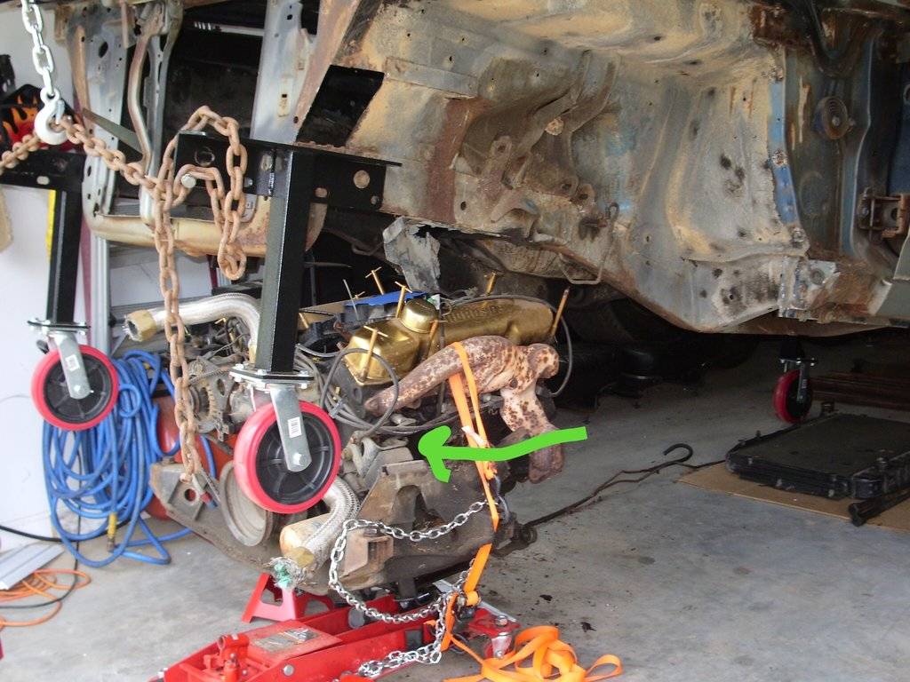

Where is the best place to buy motor mounts for my original 383 Formula S Barracuda? I noticed the LH mount rubber has a crack and when the clutch is applied will open up. It doesn't appear to be cracked all the way thru but I doubt it will take long.

I got my original driver side on E-Bay, the passenger side is used on many models and readily available. With the stick in your car, I would opt to through bolt it! It will be a little shakey in the car but never fail! :lol:
I was thinking that LH side is the one that might be hard to get for an A body big block.
Tim; Dont bother trying to find a new mount...they're next to impossible to find because most have cracked or broken LIKE YOURS.
Remove yours and have it welded and braced. Figure out how you wanna brace it.
After you get it all back together, I would recommend a Torque Strap to stop the mount from cracking again. Schumachers makes a nice one.

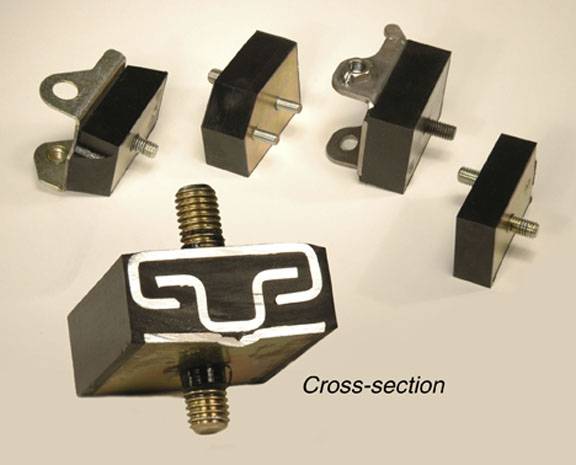

Thanks for the info. I'll give the torque strap a look see. Also will check on the Poly Locks. Anyone try those on this application. I see those things are $200 as well.

Looks like I'm off to the Polylocks now.
Polylocks suck in my experience. I have an original 383 car with headers. The passenger side mount 'melted' three times, Schumacher replaced it each time no charge. I fabricated a heat shield two different times, same result. The torque strap doesn't fit 383 cars, as you found out, so I bolted a chain to the engine, that didn't work either.
The polylocks are designed to 'lock' in place, they will not pull apart, but they will slide apart, if that makes sense. I could see the poly stretching and the motor got lower on the passenger side.

The pic is the poly-loc cross section. In my experience it runs in the wrong direction, which is why the compression force makes it slide apart and the motor sinks. They are also not fun to drill through.
I'm still leaning towards solid mounts, just thinking that would put an end to this issue.
