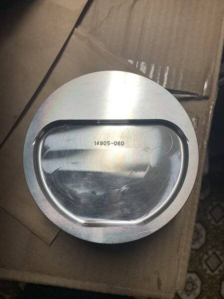

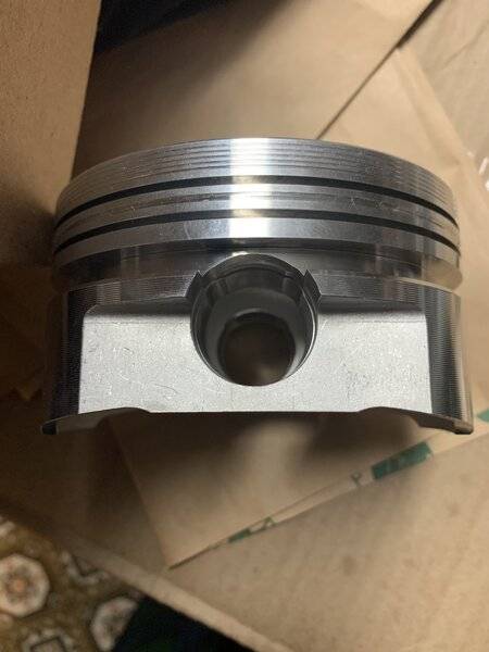

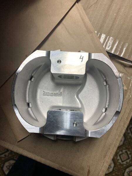

These are my pistons. Will be 11-1 with a 75cc head and a .040 gasket. This big engine needs a dished piston to keep compression down to livable levels. A bigger cc head will help also as well as a thicker head gasket. Kim
