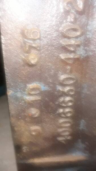

These # on the rt side of block, are these the year/casting date of the engine?
The 9/10/76 .
I thought that was the casting dates , but a guy came buy to look at the 8 blocks I have and marked the dates by some #s off the pads, and he has all different years than these casting dates. I'll have to go through them and remark them all. Thanks guys.
Casting dates will be BEFORE the build date stamp, which would definitively state the model year the engine was originally built for. BUT, the casting date is not necessarily within the model year (even with the September date). Some engine blocks were used a year or two after being cast.
