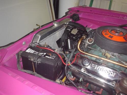

Does the lower radiator inlet clear the oil filter. Thats the problem I'm having.
Any chance you have a pic of the set up in your dart?
Thanks for the info.
Yes, with no problems. Car's in storage, I'll see if I can get a pic today or tomorrow.
Here's a couple of my 69 Dart with the Champion 22" 3 row radiator I mentioned in my post. The oil filter's black, but it's pretty easy to see it there past the radiator hose under the power steering pump. Biggest issue with removing the filter is the transmission cooler line, but it clears it.

Thanks for the pics. Very helpful you two.
