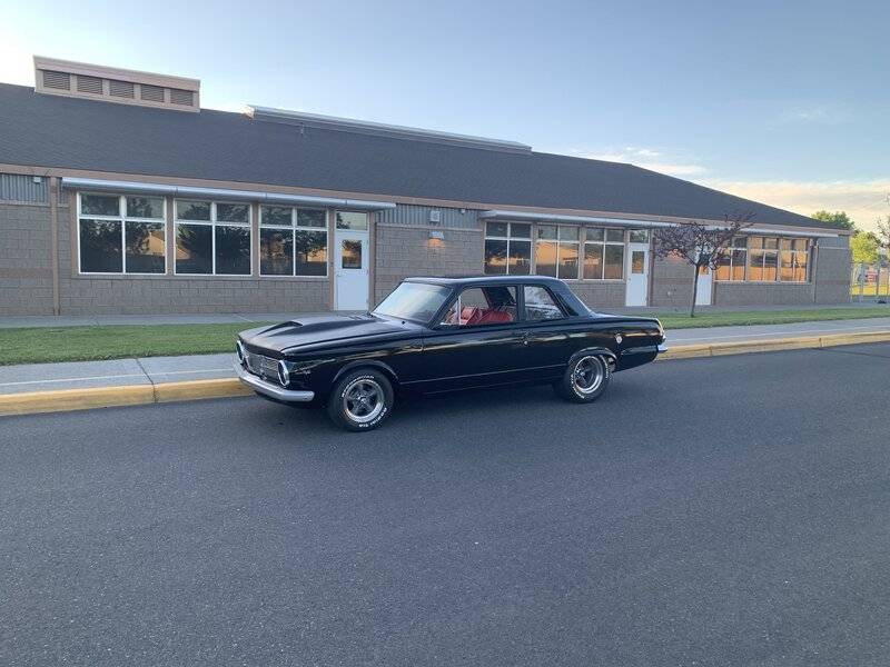

255/60r15 on 15x8 with 4” BS. Super stock springs, Dr diff 1/2” offset kit and the 8 3/4 has been narrowed to 56 1/4” drum to drum. I could definitely run more backspace and go bigger, but I’ve already got the wheels.
There is no weight on the car at all, front is still on jack stands. I might have to roll the inner fender lip on the passenger side, I might not. Im happy with how it turned out.
