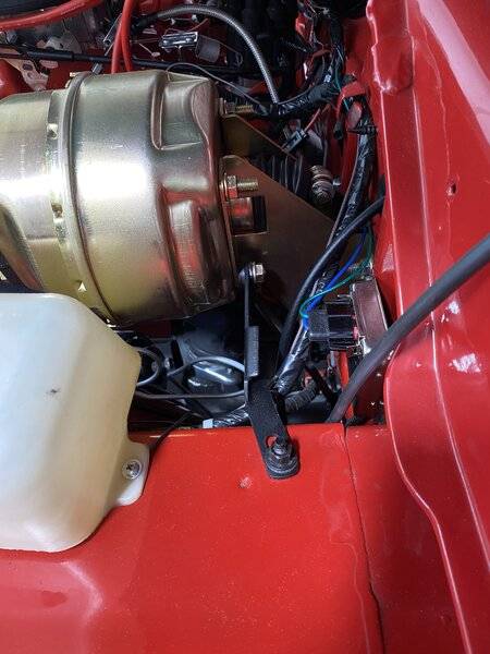

It'll fit just fine, the 67 had a 7 or 7-1/4" booster and that is what they have on file, but the later bigger booster fits with no issues. You will need all the brackets for the later booster though...

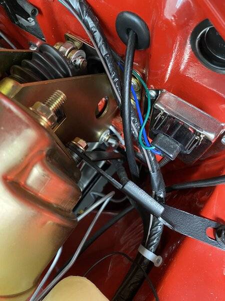

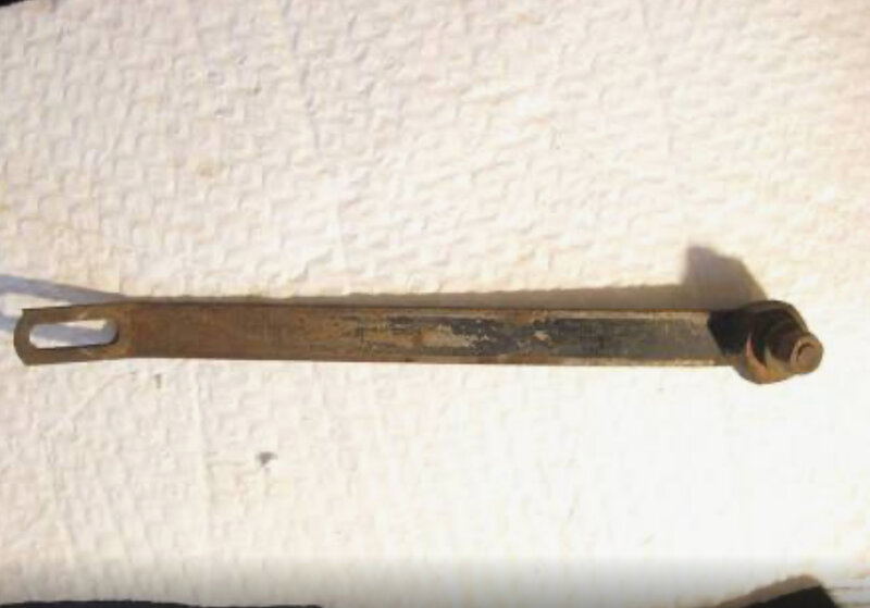

Got this for my 68 and fit great. Also found the support brackets from a member here. 4 wheel disc. Haven’t ran it yet, still putting her back together.
The bracket on last post goes to firewall with that spacer and small bracket goes to inner fender.
Hope this helps.
Hope this helps.
Thanks so much, very helpful. Last question (I promise); the firewall where the bracket mounts has an odd-shaped opening, sort of a rhombus type shape, but the rubber boot included with that booster we bought is a circle, did you attach a plate between the booster bracket and the firewall? Creating a round opening to accommodate the round weather boot? I'd PM you, but this site keeps telling me I'm out of messages (15).
I made on of these with a round hole. So the round boot fit nice and snug.

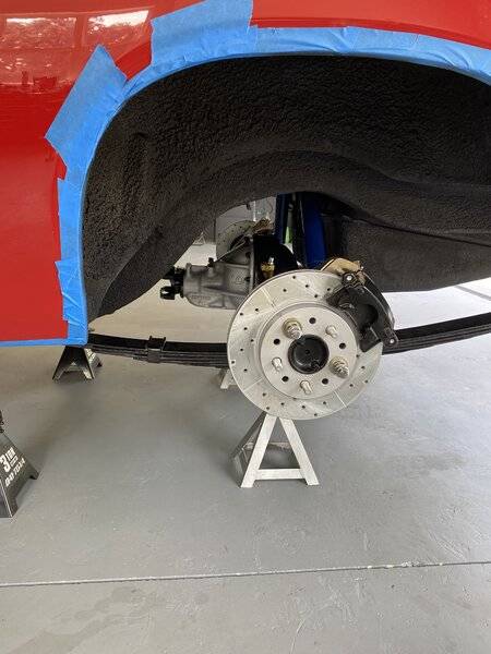

First off, thanks so much. Second, yes, you're 100% spot on; without this site (and a few others), I'd be totally lost. Love cars, love to work on em, but I'm no pro, and I have no local talent to ask for input or help, so I'm a total internet junkie for help. Crazier still, I bought this 67 Barracuda back in 2011, tore her completely down to a shell, worked on it for a couple years, then we moved across the country. It's been sitting about a decade. Talk about daunting! Thanks again man.

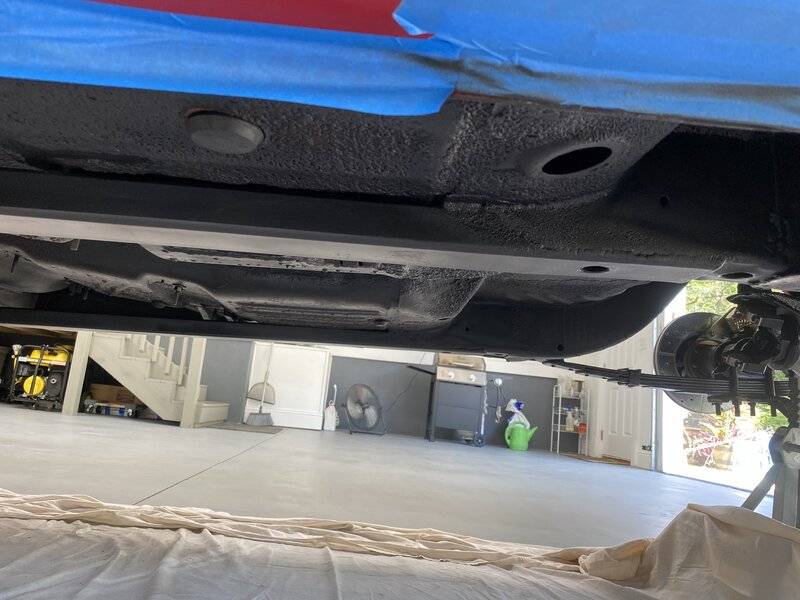

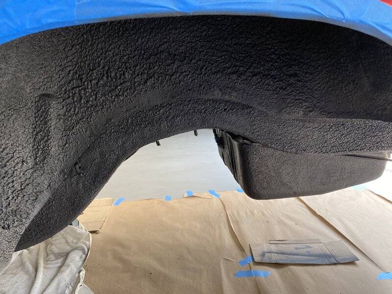

Wow that’s coming out nice. Mine was already painted (mediocre) at best. so I went backwards, underneath was a mess so I just undercoated it and called it good. Looks like ur doing way better. Good job!
