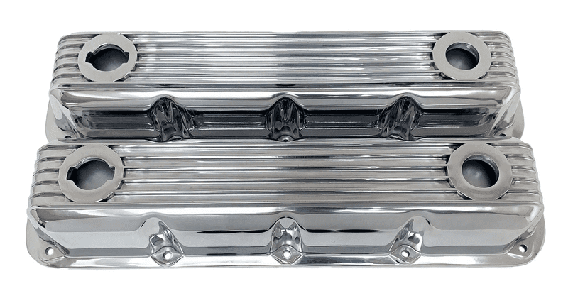

Perhaps this is well-covered already, but I'm wondering if one runs a PCV valve on the valve cover, and there are two holes, what does one put in the other hole, a breather or an oil fill cap? Some say don't run a breather with a PCV on the same valve cover, others say do it. What's the story? I don't mind running a breather or an oil fill cap, but is one more appropriate than the other? It'll be a 360 magnum, throttle-body injection four barrel, if that matters.

OP has valve covers that have 2 holes on one side
I suspect aftermarket like this.

Yeah, my valve covers have two holes each, so I'd do PCV plus filler cap on one side and breather plus filler cap on the other side.
