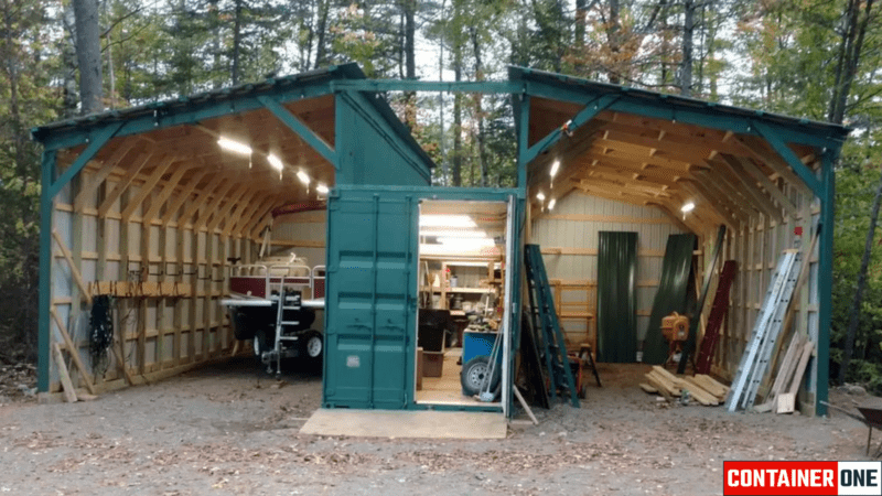

Something like this????
i think he means something more like this:
but much larger and with the roof spanning the whole foot print. i'm guessing?
Very close to this- but no walls, and two stories of container. 24' at the peak. Cooling is the issue where I live, so breezes and high ceilings are the thing. Only the metal on the roof and the perlans will be commercial sources as far as the structure goes- I am using a "trash" invasive species of tree for most of the contruction called "Melocia". Its strong and bugs hate it. Including termites! Plus it's free other than chainsaw gas. The other "enemy" to the Hawaii jungle shop is rust via humidity. Two enclosed tool rooms are planned and will have AC and dehumidifiers in them, with stand alone solar just to run them. I am doing a commercial/industrial level of solar on this, so the big ceiling is a plus. I hope to get eventually 100 550 watt panels up there. I have already bought 20, which is more than enough for a house. I will have a 20kw diesel generator as well. That will run power- hungry things like compressors. I already have my welding generator for welding.
