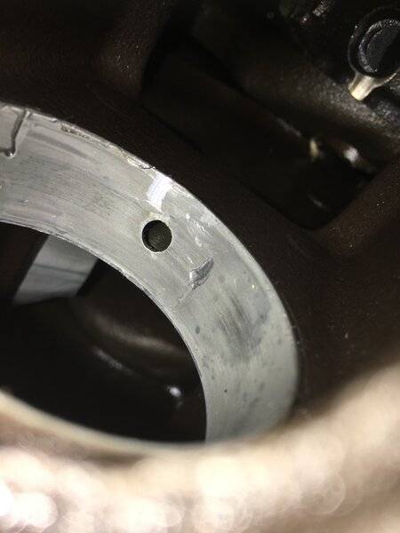

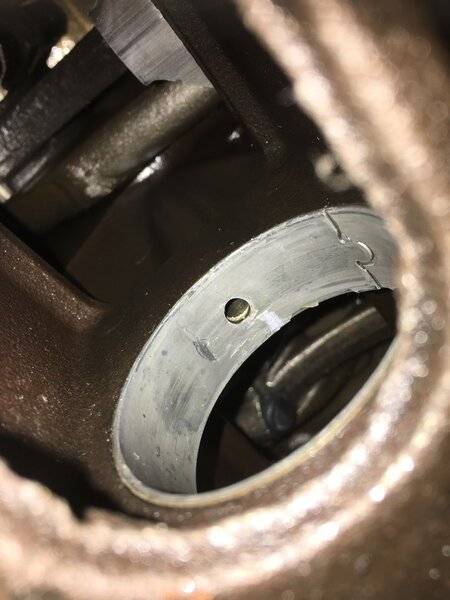

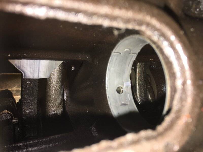

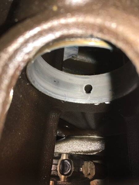

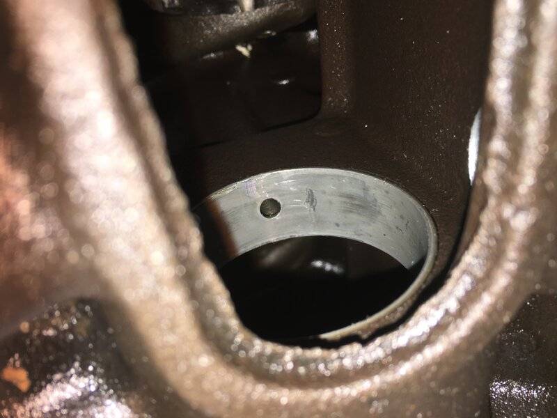

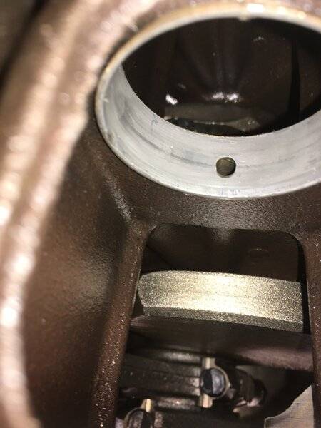

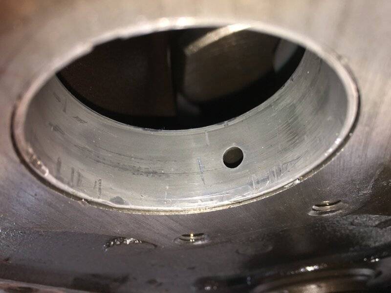

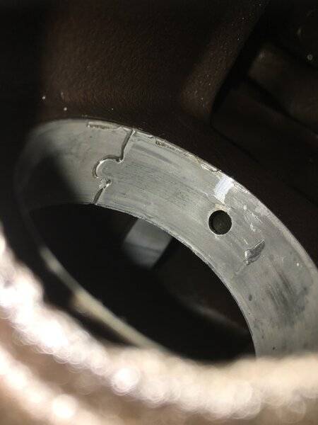

I’m in process of putting engine together. Not a rebuild, I just wiped cam bearings with a dry towel. I realize they’re coated but can I get anyone opinion if they’re fine or not. I don’t feel anything of concern and while I don’t think I nicked anything, the cam did tilt a tiny bit upon removal while it was maybe halfway out. Cam lobes seem fine. Any input would be appreciated. Lastly, I had lifters out to the side in order it was removed. One side was knocked over by accident. While I’m aware theres a wear pattern. Am I left with no choice but to replace all?

Picture #1, 11-12 o-clock position of that cam bearing, at the parting connection is that missing bearing material?
Picture #1, that piston skirt looks like no hell.
Yes pic 1 looks like the coating has worn out a bit. Piston skirt is no hell?
Bearings generally look OK. Any nicks can be smoothed over with a file or sandpaper. Make sure oil holes are oriented correctly to block.

The damage looks like installation damage: damage installing the brgs & damage installing/removing the cam. A few nicks here & there. Wouldn't worry about it unless it is for a long distance Nascar race.
Sand paper is usually not a good idea. The grit gets imbedded into the bearing. You can carefully scrape the high spots. The issue with cam bearings is you knock out the old and install new ones with surgical precision. Not a knick, not a scratch!!! Then you go and try and install the cam and it won’t turn!!!! If you get it in!! You can send the block out to have the cam bores “corrected” if you can find someone who can do it correctly or you can do what I did and cut diagonal grooves in an old cam core, lube it up and slowly turn it as you push it in. Pull it out frequently to clean out the grooves and relube it. You can cry a bit at this point, I did, once you get it in and turning smoothly. You need to clean the oil galleys. It’s heart breaking, but works.

I would polish those camshaft bearings with some very fine steel wool. and blow everything out really well. I wouldn't run them as is.

In a pinch I have used 1000 grit Emery paper to remove slight imperfections in old bearings never had any issues, very light pressure small area not the whole bearing. Back in the day scraping bearings was the only way to make them fit, kind of a lost art, pretty tough to due to a cam bearing that is installed already.

If you got it apart... I'd change those ******* cam bearings.

I wouldn't be using any abrasive paste on soft brg material, where it will embed itself & cause future problems.
Test fit with used cam, angle reliefs cut in and dressed. Good coat of engine assembly lube on bearings and cam journals.

I say no to any sand paper as the grit will imbed into those soft bearing layers.
The fine steel wool sounds like a better alternative if you need to go that route.
