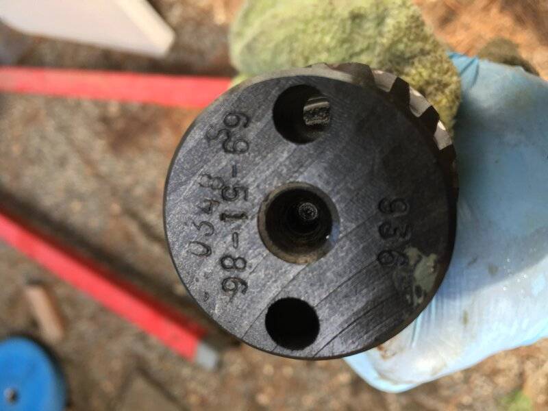

Can anyone identify this cam?

Came off a 340 from a 68’ barricuda. I’m pretty sure it’s not stock. Was supposedly installed in the 80’s.

That is a good cam for a mild streeter, stock converter type deal. Get the idle tune up right and it will run OK.
No reason to toss it if it was working. Degree it in, set idle timing at about 14-16 and total around 34-36 in at 3K and it should run nicely.
There are some other cams that have more area under the curve and will make more power than the one you have or the one I recommended. But we'd need to know how much compression you are planning on and what you're looking at in the way of headwork and your overall performance goals.

It so close to a factory 340 4 speed cam it's not worth the $ to change it. JMO.
It is a good cam and will run fine with a good tune up. MY 70 340 4 speed Dart ran 102-103 with that cam, LD340 and 750 DP, 3.91 gears. It scoots pretty good. and better than the factory std 340 cam. IMO, run what you have.
