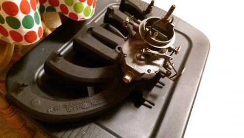

I feel that my setup is unique since my carter 4421 looks different than alot of the pictures I've seen. This pic is it mounted to the intake manifold I got for it.
That's a '68 318 carb, which means the choke lever won't hook up directly to the \6 choke. Get the № 1232 electric choke kit and make a new choke pushrod out of brass rod stock from the hardware store, and off you go.
