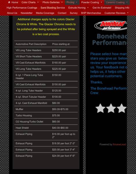

Any brands or where to get this high heat thermal coating as used on tractors. I thought about the ceramic coatings, but couldn't find anyone that did this anymore, plus shipping exhaust manifolds, or headers is very expensive. Let me know if you know.
We have a local powder coater here in my city, and he has it available for $75.00 Canadian. He blasted my new bare TTI headers, coated them then put them in the big oven. 22 dyno pulls and two years in the car and they look brand new still. I read that John deer has a similar coating process.

Jet hot in north carolina quoted me $300 for slant six long tubes, inside and out, with a lifetime warrenty. Since these headers are NOS, and haven't been made for many years, I think that's the way I will go. I can save shipping, by dropping them of on my way to a race in June. Only about an hour out of my way.
