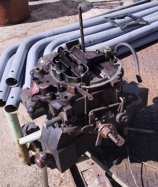

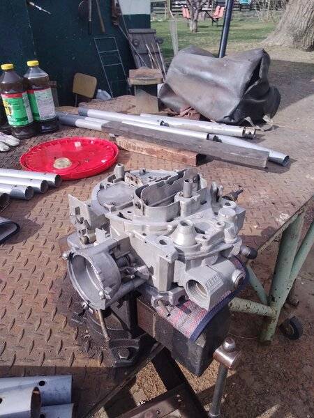

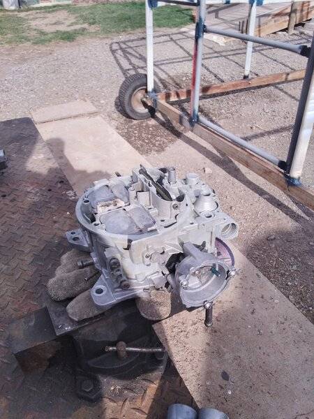

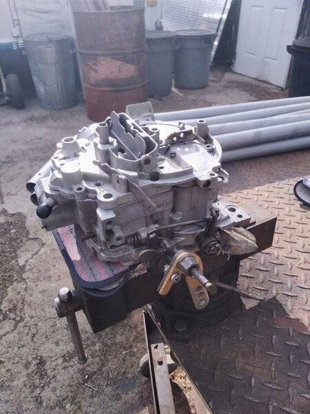

Cleaned my carb with Pine sol
jonnyrose
Aug 30, 2017
227
89
canada
I did a 50/50 mix pine sol and water 48 hour soak time,can't believe it worked.
