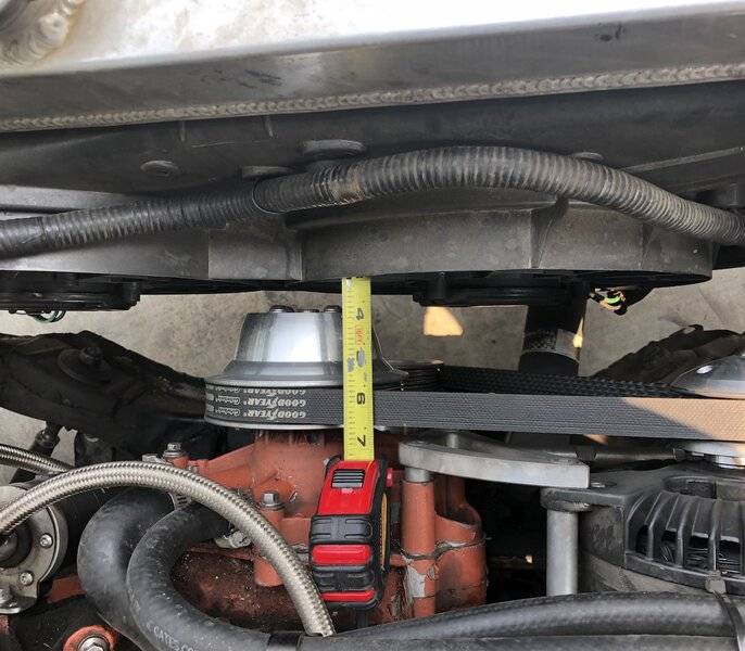

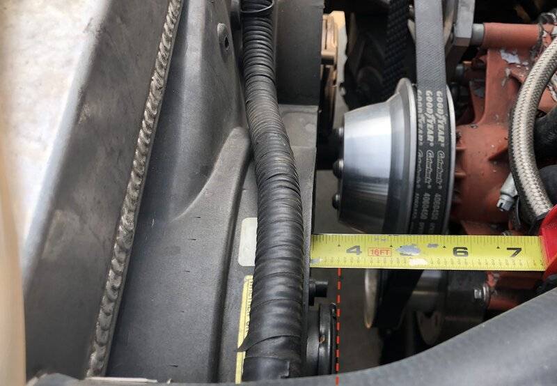

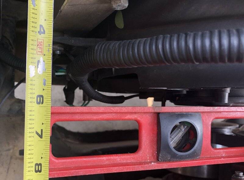

You need to check the distance I just bought a cold case with the electric fan and did not have enough distance for it to fit. You need at least 6 3/4 inches for it to fit or a little more had to send mine back to jegs.
Dang, that's a lot. The '95-2000 Ford Contour set up is only about 3.5" deep at it's widest point, which is to the back of the motors. The rest of the shroud is about 3". With my 3 core Champion 26" radiator and the Contour fans the back of the fan motor is about 6" from the radiator support. Even it probably wouldn't fit if the fan motors were inline with the water pump pulley. Fortunately, with the dual fan set up the motors aren't centered so the deepest part is offset from the pulley. Something else to consider when looking at a particular fan arrangement.
