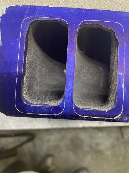

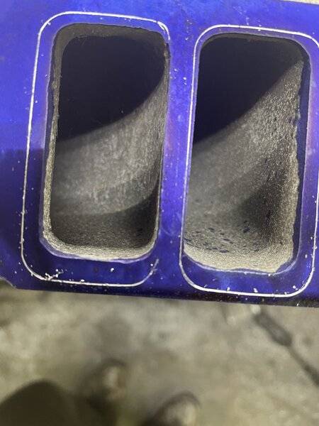

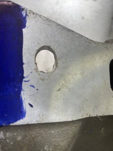

Almost have another set of Edelbrock heads ready for a valve job so I figured while I still had my coveralls on I would get a jump on the Victor340 intake manifold. Man I’m about disgusted in the direction Edelbrock and their quality control or lack of it is heading. Look at these out of the box ports.

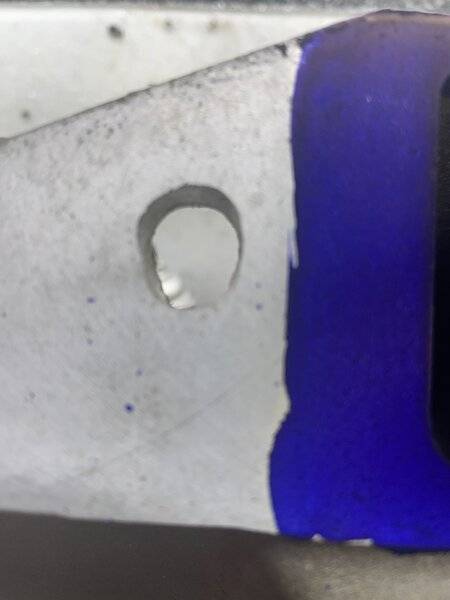

Ohhh well sometimes you gotta know when to take a break. Doing enough of these I know where to place the gasket to scribe my lines but I use 7/16 bolts when I can to center the gasket. Well when someone self grinds the holes for more bolt clearance at all different kinds of angles it really makes things fun. Then when they stick it in the mill to grind the top of the manifold so the valve covers don’t hit now they took gasket sealing surface that I need to raise the port to where it should be. Please Dont do this guys. If you need more clearance just flip the manifold over and hand drill bigger holes.

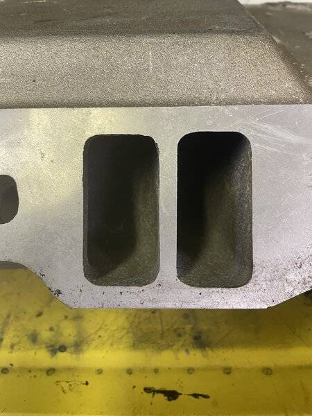

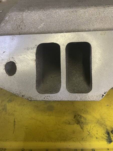

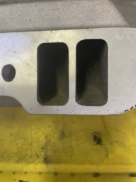

This is a used set of heads and intake and I should post up pictures of the rocker stand castings. Speedmaster is putting them to shame. But I sure like doing valve jobs on the Edelbrock heads compared to speedmaster. They just cut and look cleaner.
Is there green sand still falling out of that gasket surface??!! Holly ****!!

I received a new Victor 340 just a few months ago from Summit after them having been out of stock for some time. I assume it’s from the new foundry. Can’t say definitively. Had to slot the mounting holes a little with a die grinder be able to line the ports up, but overall the intake ports were nowhere near whats shown here..

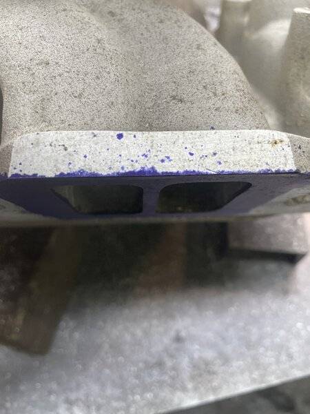

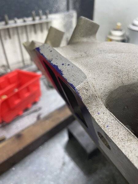

Ok guys what would you do. This is where the port should be but because the top was milled off you can see how much material is left. I wont rely on that to seal and have a couple ideas. What would you guys do. The thin area is the top of the port. The best area to have.
That hurts more than the fubar opening..
Just a blind guess: angle mill or just mill the head to try and give you meat to raise the intake in relation to the head?
Gotta be better than welding another 5lbs of alloy over the runners..
That's pretty shaky all right. I'd probably take some off the floor, but not all the way to the line.
Otoh, i got away with this port, on a tm7 that was modified (not by me) for maxwedge heads. The bottom of the valley under each port was also ground for valley pan clearance.
Oops, just read the text again that the thin spot is at the top. My tm7 has some slugs of aluminum welded to the top of each pair of ports. Not pretty..... but they don't leak.
Do I understand correctly; you have the heads too, and that is where the gasket needs to be to line up? Is the head opening that big too?
I am guessing you’ll be welding the intake or milling the deck surface of the head to lower the top of the port?
